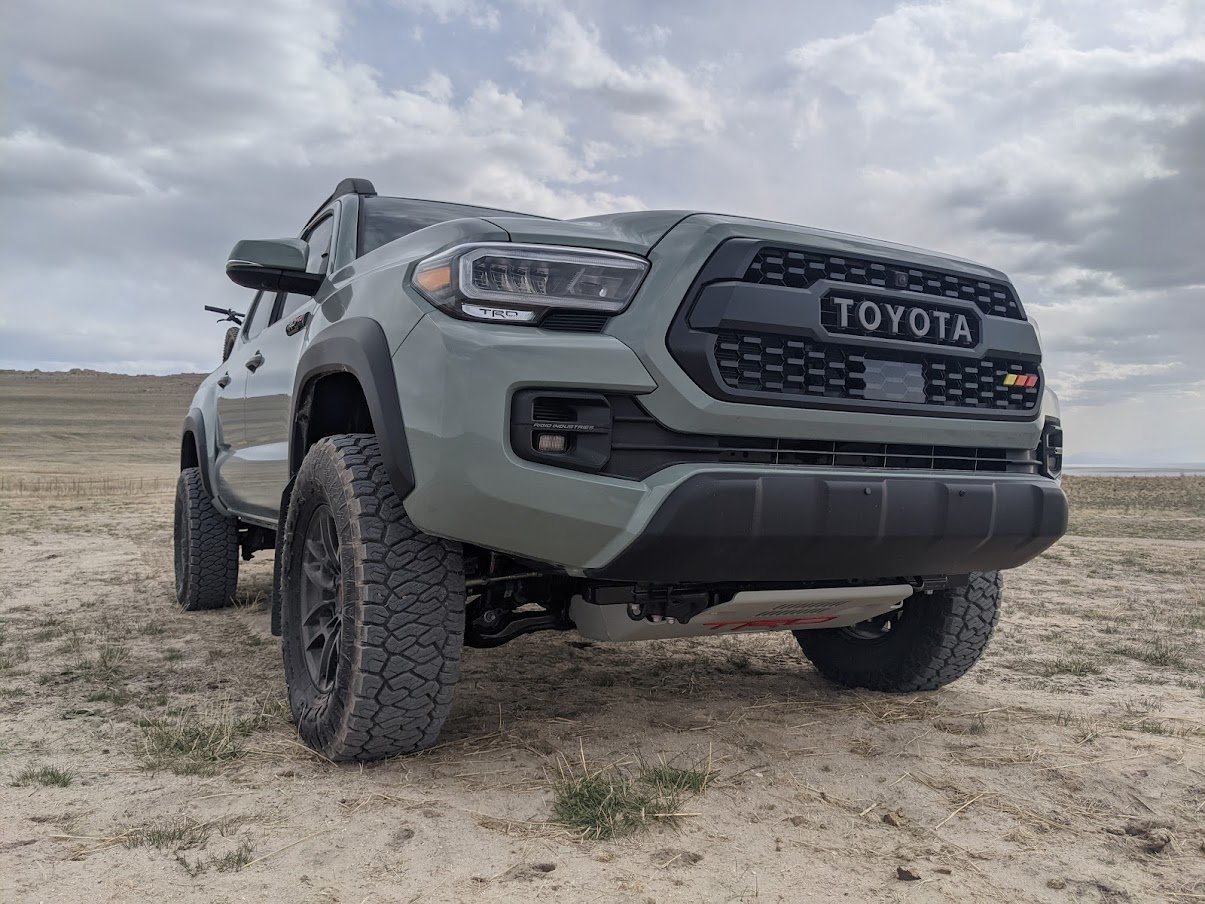

    No affiliation, but a better understanding of tire ply's and load ratings, etc, is part of why I chose the Maxxis RAZR AT 811's. A really chunky, 3Peak M/S, well rated off-road tire (in AUS/NZ) and only 38lbs for the SL rated 112T version.
    fW-JIu1IYDXag37IDzk8x8WRcwUInGZEQjzAFcmz_85f8a446d754e5b3da62441ff64f8a7a9a54ff14.jpg
