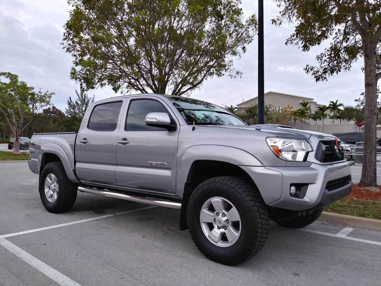

    Istalled a 2" leveling lift , 1.25" Spidertrax spacers , nothing on the rear .Tires are G2 Grapplers 285/70R17 on stock rims. No rubbing and left the mudflaps on. Bigger tires than the stock 265 65 R17 will rub on the inner wall against the UCA , you need to spacers to resolve that.20181219_164622_HDR.jpg
