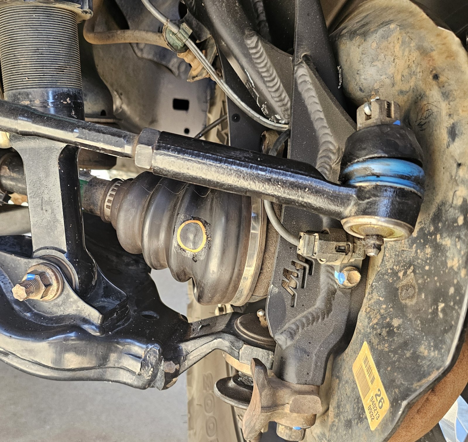

    What do you think? I had a very small tear in the Boot and I fixed it just after it happened. Probably means this boot will tear in another place so this is not a long-term solution. I have backup axles but kind of want to see if these will last before replacing

    1,140
    2013 Tacoma
    going to guess not long as they are dissimilar rubbers and the cement to hold the patch may not adhere properly. this is my guess...but we shall see!

    Billy
    2020 TRD
    I bet the boot will tear elsewhere before that patch comes off. That's assuming you properly cleaned and prepared the boot surface prior to application of the patch.

    FWIW, I put black RTV on a pin hole on a boot and it survived over a year

    Depends on how much you drive. Park it and it will last for years.

    That's not a bad experiment to try. It will definitely buy you a certain amount of time.
    If the patch blows or it tears elsewhere, it does mean that you're keeping a lot of shit out of the joint in the mean time and it should make cleaning it up and re-booting it a heck of a lot easier when you get around to swapping the axle.
    If that's an OEM CV axle it's definitely worth re-booting if it's still decent inside, and swapping out as a core for a CVJ unit - https://www.cvjreman.com/product-tag/9808/ - if it is not.

    Update. I have been driving the truck almost every day and doing some off-roading. It's been a couple weeks and the patches have lasted. I actually had a tear on both sides and patched both and they're both still holding. However over the weekend I went and did some rock crawling and formed a new small tear on one of the boots. I patched it and kept going

    Which patch kit did you use that is flat like that, all the ones I see/use have like that rod of flexible sticky stuff you jam in the hole on your tire

    I think that's a bicycle tube patch

    Update. I ended up patching a total of four holes. One of the patches is still holding strong but three of them are starting to peel off. I think this is a good short term solution.
    Today I installed new axles from CVJ on both sides.
