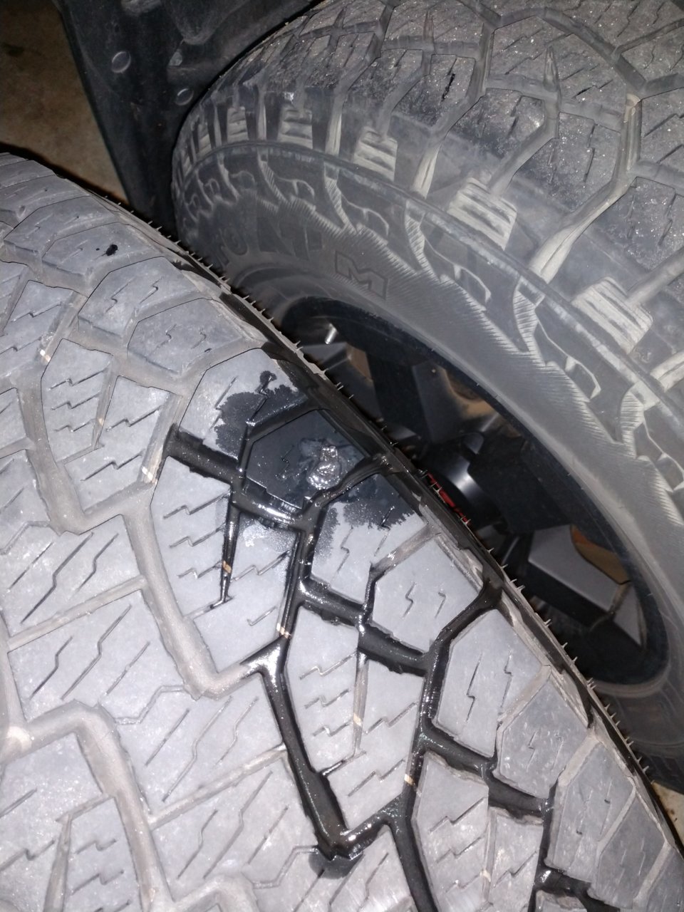

    replugged the tire last night with a thicker plug and over did the cement. let it sit overnight and filled it up this morning. did the water-detergent test and looks like there is no more leak.

    That's good news. I think it would be helpful to post occasional updates on how it holds up since tire shops won't repair a puncture this close to the sidewall. The reccomended process is to patch the inside as well but for emergencies that's not always an option.

    still holding up. 51psi.

    good work OP, just keep an eye on the PSI for a few days and youll be good to go, no reason to buy a new tire or pay a $100++ repair for something like this,
