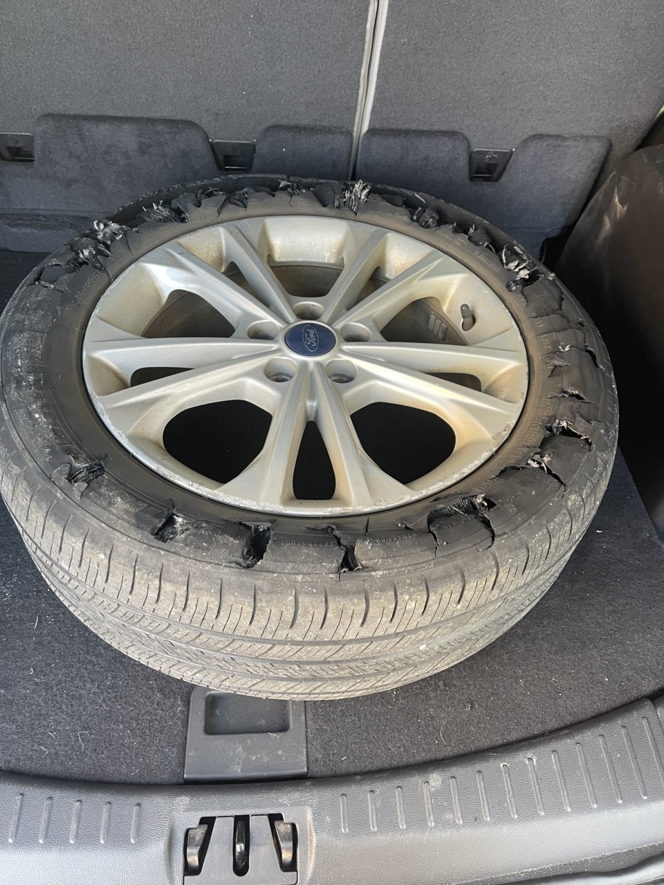

    Tangentially related… my friend ran over “a nail” the other night in his Explorer and sent me this :eek:
