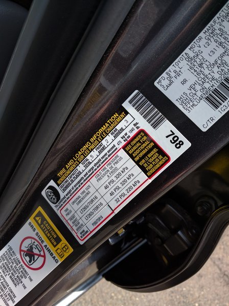

    I just picked up a 2014 Taco double cab off-road. The manual says around 33 PSI for tire pressure, however, the door jam sticker says 46 PSI. To me that seems high and it appears that a new sticker was added on top of my factory one.

    Nope, that's high. I run 34 PSI in the front and 32 in the rear. Every truck is different depending on the tires, and a few other variables. If you want it to be PERFECT, google the "chalk test" and it will show you a process for that. If you're lazy like me and don't want to do that, just put them around 32-34

    46psi is fine lol

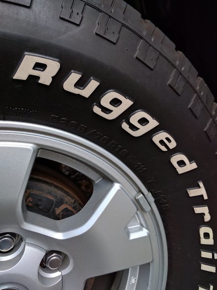

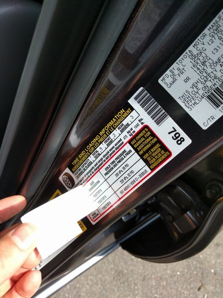

    My wheels say not to inflate over 40 PSI. I checked the other door jam value under the new sticker and it was for 29 and 32 PSI.

    Just being a stickler here but your tire says the pressure not your wheel. Peel of those top stickers and go with what the original says or do the "chalk line" test. For what it's worth my tires say not to exceed 80 psi, because they're load range E, I run them at 40 psi.

    Looks like they put the wrong extra sticker on your truck, or your truck was destined to be a TRD Pro / Baja with the LT BFG KO's that need those pressures..... either way, go with what the actual tire says and what wear looks like..... with the stock BFG Rugged Fails, ~ 32 in the front and 29 in the rear seemed to be best... never understood why they had more pressure in the rear when its much lighter unloaded.

    Your door sticker is for LT tires, the original sticker is for P rated. Your current tires are P rated, so go with that number. Like the other poster said, at one time your truck must have had LT tires on it. Maybe the original owner had the dealer trade the tires when he turned it in?

    OP compare your actual tire size with the sticker. Then compare pressure between the actual tire rating and the correct sticker.

    If I remember correctly, there was a recall issued in 2014 addressing incorrect door labeling for tire pressures for the TRD Pro/Baja trucks with the beadlock-style wheels and BFG KO (D-rated) tires. Check the recall route. It's just a new sticker in the door sill and a reprogramming of the TPMS threshold pressures.
  18. Jul 14, 2016 at 2:34 PM
    #18
    FooBird
    FooBird Well-Known Member
    Jul 31, 2014
    #135166
    539
    Kirkland, WA
    '14 DCSB 4x4 TRD Off Road
    Recall Number
    14V475000
    Recall Date
    08/04/2014
    Component
    EQUIPMENT:OTHER:LABELS
    Summary
    Toyota Motor Engineering & Manufacturing (Toyota) is recalling certain model year 2008-2014 FJ Cruiser and Tacoma vehicles equipped with accessory wheels and tires installed by Toyota or dealers prior to the vehicle's first sale. The affected vehicles may list incorrect spare tire size and/or cold tire inflation information on the tire placard. As such, these vehicles fail to comply with Federal Motor Vehicle Safety Standard No. 110, "Tire Selection and Rims for Passenger Cars."
    Consequence
    If the spare tire is inflated to the incorrect pressure provided on the placard, tire failure may occur while it is being driven on, increasing the risk of a crash.
    What Owners Should Do
    For the involved vehicles, overlay stickers to correct the tire placard will either be mailed to owners or provided to dealers for placement over the incorrect information on the placard. The recall is expected to begin in September 2014. Owners may contact Toyota customer service at 1-800-331-4331.

    Toyota recommends 46 psi if the truck came with LT tires from the factory or port installed.
