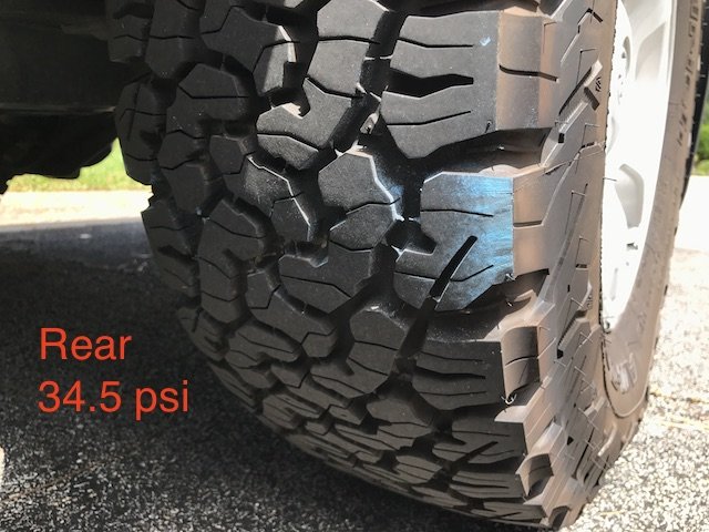

    I just got a new set of BF Goodrich K02 tires and Discount Tire set them at 36 psi (front) and 38 psi (rear). I took her down to the beach and aired down for the soft sand sections. After airing back up to 35 psi (front) and 37 psi (rear), I completed the chalk test.
    I made a nice thick chalk mark and drove straight 5-10 mph for about 150 yards. I have about 250 lbs of Snugtop camper shell weight on the bed. Here's some photos of my results.
    For now I'm going to pick 34psi as my optimal front pressure and keep the rears at 32-34psi.
    Rotate often!

    What load range are these? Based on your chalk test I'd consider dropping the fronts to 34 and the rears to 32 and then retest.

    There is still chalk showing on the edges, especially on the rear. That indicates over inflation. The center of the tires will wear out sooner since the edges aren't in contact with the ground.

    ok, but doesn't it make sense to run the rear a bit harder for occasional hauling weight in the bed?
    I also thought that a small amount of chalk on the very edge was desirable?

    When you are actually hauling a load, up the pressure. I run the rears on my F250 at about 36 when it's empty and up to 70 when I'm actually carrying a load. Longer tire life and smoother ride.

    Im going to edit my post and try 34psi front and 35psi rear. I load the bed frequently but rarely more than 200 lbs.
    I will try to retest this week.

    If 200lbs is the max you load, then I would still say 32 in the rear. 200 lbs is just one average sized dude. If the loading characteristics of the truck and the tires were that finicky that it needed adjustment as you took on and let out passengers then there'd be a lot more crashes.

    Sorry for the delay in updating my thread. The Houston weather has not been chalk test friendly. Just did another test today. I'm working my way down to @Maticuno suggestion.
    The tires were really hot today and I drove the same distance as last time.
    Does anyone know why Toyota specs the OEM rear tires at 32 psi (3psi higher than the front spec at 29psi)?

    On the assumption that you might actually be hauling something in the bed. The ability of your tires to carry their rated load depends entirely on the air pressure inside of them. That's why E rated tires have a much higher max pressure rating. The door sticker on my F250 calls for something like 70 psi for the rears, but that's only if I'm loaded for bare. I run 36 front and 34 rear if I'm unloaded.
    As for the recent chalk test, your fronts look almost there, and just a bit more out of the rears.

    I’ve running 34 front and 32 rears or really close to that for pavement and it’s been perfect. Carry a pump on board to air them up for hauling/towing or after going off road.
