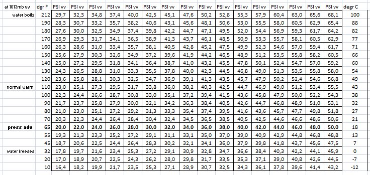

  15. May 8, 2018 at 5:39 AM
    jadatis
    jadatis Well-Known Member
    Dec 15, 2015
    #172311
    55
    Peter
    The temperature/pressure change is already explained.
    So in winter your 29/31 psi, becomes higher in summer.
    Then if you lower the pressure at summer to 29/31 you do it wrong.
    In summer the tires need the higher pressures to give lesser deflection so lesser heatproduction.
    This because then cooling down of tire is also less because of the lesser temperature differences between rubber and in and outside air . Then the rubber still wont reach a temperature at wich it hardens ereversibly and every new bending by deflection tears these damaged rubber parts a bit further until after a few years a blowout and accident and the missery that goes with it.
    When you lowered your pressure , you give tires more deflection so more heatproduction so temp in tire rises more %.
    From cold to warm when driving constant 55m/h will rise the pressure about 10%.
    Cold is when inside tire temp= outside tire temp, that simple.
    Advice is given for 18/20 degr C , 65/68 degr F, and the within a range of outside temp, the warming up/cooling down story stays in balance so rubber wont reach a critical temp.
    Will give a picture I made with Excell about the pressure /temp relation, in wich you see that the rule of tumb given , only goes within a sertain range of pressure .
    Greatings from a "Pigheaded Dutch Selfdeclared Tirepressure-Specialist"
    Peter
    djmr1972[OP] and bshammer0 like this.
  16. May 9, 2018 at 1:37 AM
    #16
    jadatis
    Dec 15, 2015
    #172311
    55
    Peter
    When I look at your Avatar , its a semi-truck with large tires.
    You probably have chanched the P-tires to LT -tires and those need a higher pressure for the same load on them.
    EDIT: Reading back I see you have stock tires, so then advice should be alright.
    But do you know for shure, check it and compare tiredata with tires given on same plate as the pressure -advices.
    I am able to calculate a save pressure for you if you give next.
    From car: Best seperate weighed wheelloads in the loading you use the car, so with all the persons and load in it.
    Second best is weighing axle loads, but I think we have to do with Empty weight, GAWR's ( gross axle weight ratings), GVWR ( V for Vehicle) , and the way you load it, so what and about where. GA/V WR can be found on the same plate as the pressure advices.
    Then the maximum speed you wont go over for even a minute .
    From tires 3 things, and mostly can be read from sidewall( check if all the tires are the same).
    1. Maximum load or loadindex
    2. Kind of tire to determine the pressure for wich the maxload is calculated up to 160km/99m/h mostly.
    varies from P-tire ( P in front of sises) in Standard load or XL/reinforced/Extraload, C-load/LRC/6PR,D-load/LRD/8PR, E-load/LRE/10PR.
    On LT tires the pressure behind AT I need, and is called in the official formula reference pressure, and for P-tires is not the maximum cold pressure given on sidewall.
    3. Speedcode , a letter mostly above Q ( 160km/99m/h) , R( 170km/106m?/H, S,T,H,V,W,Y), But some LT have N speedrated for max 140km/86m/h, but max speed of tire must be the same or more then maximum technical car speed.
    Have been playing with your pressure risings in the list I gave and saw next
    In winter you had rounded 30 psi all around( 29/31) cold pressure.
    Assume 29 to be measured at 32 degrF( freesing point) and 31 at 55degr F . then it will be at advice pressure temp of 65 degr F 32 psi.
    Then it has risen to warm pressure to 38/42 wich is then inside tire temp of 130 to 180 degr F. I concluded in time that 140 degr is the max of temp in tire , then rubber wont yust not reach its temp at wich it hardens ireversible.
    Now lowering this warm pressure from average 40 psi at 150+ degrF to 34 psi at 150+, it will become cold at 65 degrF. interpolated it as 27.5 psi, wich is 2.5 psi lower then advice.
    This gives about 20% more deflection of tire so 20% more heatproduction ( if that is a lineair relation) , pressure rose still to 38 , and looking in the row of 28psi at 65 degr it means an inside tire temp of 190+ degr F.
    And the temp in tire is related to the hottest part of rubber, and is the thing what is important for savety of tires.
    This all makes me suspect you have those probably even E-load tires with 80 psi for wich maxload is calculated, and your advices on car ar for OEM tires of somewhere between Standardload P-tire to C-load LT.
    Then my calculation will come to a higher cold pressure wich rises then only a good 10% in pressure so inside tire temp about 115 degr when driving about 55m/h.
    Driving faster means more cicles a second( 55m/h about 10cycles a second). so more heatproduction a second.
    for higher speed you then need higher pressure to give tire lesser deflection so lesser heatproduction a cycle, so heatproduction a second stays the same.
