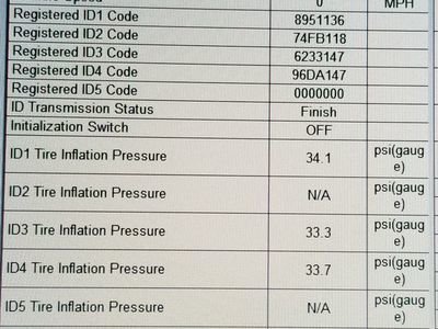

    Best bet at this point is for OP to either plug in a Snap-On Solus like @b_r_o suggested or take it to a shop. They can take a peak and will probably see something like this image that I stole from google that probably came from Tacomaworld:
    As added info a standard OBD-II reader will not read TPMS stuff, you will need a more expensive device that says it can read Toyota stuff, like the Solus.
