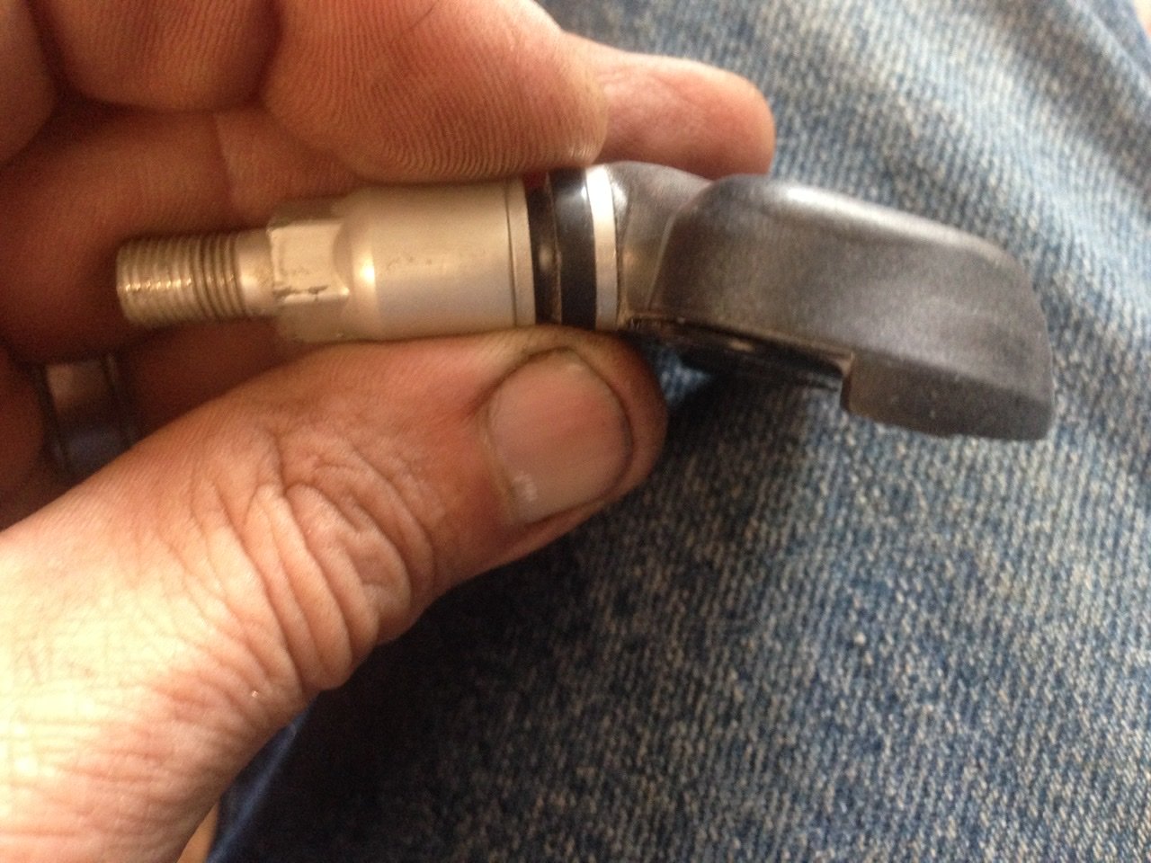

    Here’s a TPMS sensor. The black ring goes in the wheel. Everything left of the black ring will be visible outside the wheel. If you have that funny looking long aluminum nut, you have TPMS sensors. If you determine that you do have sensors, Discount Tire has a magic wand that they can wave beside your wheels and determine if any/all of them are dead.

    You would have thought for all the time I worked at tires plus I would think to just look at the valve stems lol.... I am not smart.

    Yarp. Left rear is missing, just has a standard valve stem. I went from ASE back to IT, I get stuck in the computer mindset sometimes. I was just thinking I would scan for the sensors, didn't occur to me to use my eyeballs haha.
