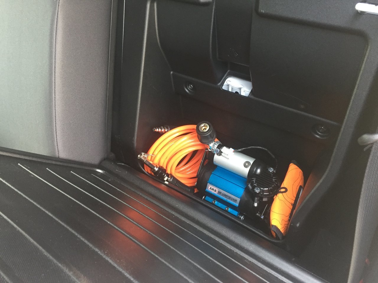

    Yes. On board air is money.
  12. Mar 21, 2018 at 10:27 AM
    EDLawrence
    EDLawrence [OP] Active Member
    Mar 19, 2018
    #247719
    38
    Raleigh
    2018 White Tacoma SR5
    I have been looking around trying to find somewhere to mount it on the truck so that I can remove it easily once my lease is up, I can get to it when needed, and so that it is out of the way when I don't need it. I also want to have it wired in and a switch on the dash to turn it on when I need it. Since I am also planning on putting a power inverter in one of the stock bed boxes, I was thinking of just getting a large enough wire (about 4 gauge, to be able to handle 60 A max) and have the compressor possibly between the bed and the fender, near where the inverter would be.
