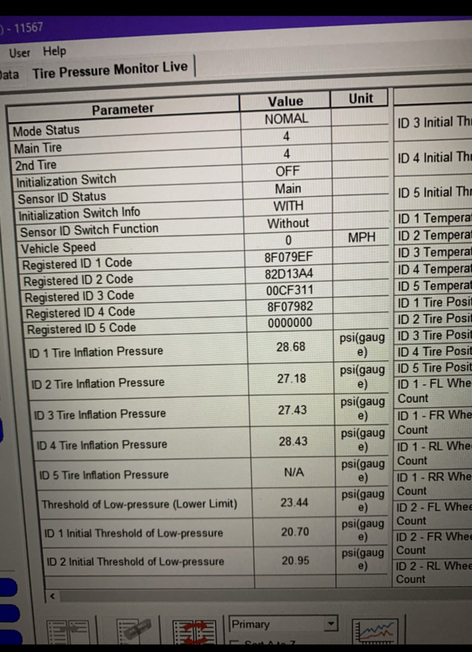

    The fix is use Techstream.
    I’ve had my truck 5 years and rotated my tires many times, but the last time (a few weeks ago), after rotating my tires and pressing the TPMS reset button, I had no numbers displaying, just the —- after a week of driving. So after researching it, I opened techstream, saw that my IDs were in there and the sensors were reading normal, but the location said “judging“. I deflated a couple tires to find their location (techstream shows pressures), then manually assigned them to their location. I had to write the IDs down to have the numbers available when switching screens, but did not take long. After I did this, the correct pressures were displayed immediately and in the right location.
    Next tire rotation, I will try the reset button again (it always worked in the past), but have a backup if needed.
    If you need techstream, read this thread
    (You’ll also need a cable to connect to your truck)
    https://www.tacomaworld.com/threads/ecu-tsb-update.562550/
    Or bring it to the dealership and tell them to use techstream to manually place the tires in their correct position.
    I don’t have pics of all the screens, but here’s a pic of the screen that shows the TPMS info/IDs.
