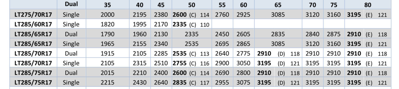

    Use this to convert Toyota’s recommended pressure for stock tires to your new LT tires: And adjust from there. IIRC to keep the same load carrying as stock you should be at 37 or 38 psi.

    You have that backwards. E rated requires less PSI to take the same load as a C rated. (Width of tire will also dictate PSI to load, Ie wider tire less PSI). It’s the load that the tire is taking that’s THE most important factor with PSI under normal / everyday driving conditions.
    example, E rated at lest say 40psi will take the same load as C rated at 60psi. Each tire is different and the manufacturer will post that information (Also written on the sidewall), that should be your starting point for PSI, using that against the actual weight of vehicle, or you can use chalk trick or cold / warm temp, and even cold warm PSI change. Plenty of correct (take the guessing out) ways to do this.

    Almost all of this is wrong. See the load chart below from TOYO:
    https://www.toyotires.com/media/2125/application_of_load_inflation_tables_20170203.pdf
    C Load and E load tires in the same size have the same load carrying up to the same pressure, but C load tires have a lower maximum pressure so e load can be inflated more and therefore carry more.
    Air pressure is what carries the load, tire construction just contains that pressure. E load tires are more heavily constructed than C so they ride stiffer and are heavier.
    To find the load-based tire pressure for whatever size you change to, start with your door sticker and either use the chart or the calculator I posted before.
