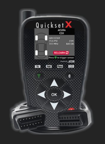

    Yes this is what most people typically do. Just ask any tire shop to relearn the winter tires when you put them on. Or see if you can get your hands on a sensor tool. We get them free with a box of sensors so they can't be that expensive I figure. While you can't have 2 sets simultaneously shown, you can make it work so long as it's all programmed correctly

    Unfortunately, I'm only familiar with the autel tools. Those are for pretty much every manufacturer. Also Unfortunately, the tacomas do not have an automatic relearn procedure, so you will need a tool. I would call a local tire shop though. At our shop, we don't charge for a sensor relearn.
