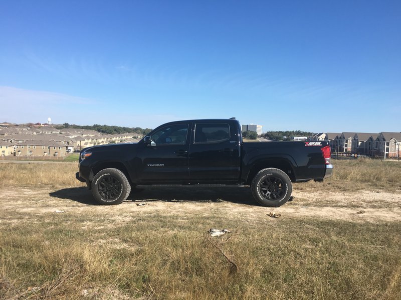

  19. Jan 28, 2017 at 7:43 PM
    #19
    Dirty boy
    Dirty boy [OP] Member
    Dec 22, 2016
    #205506
    14
    Jerry
    Toyota Tacoma
    6inch lift with 20inch tires
    IMG_1037.jpg IMG_1037.jpg Here is a before pic
    SilverII likes this.

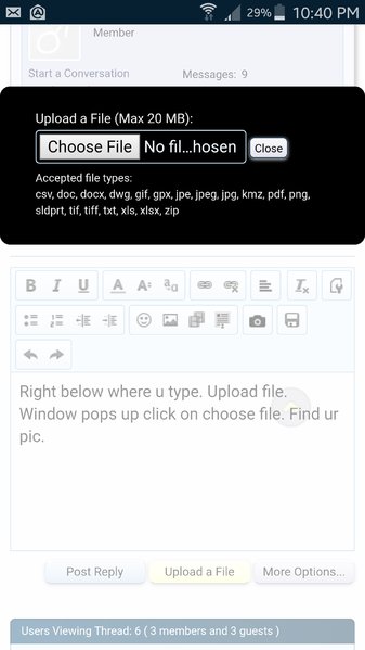

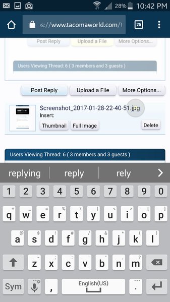

  20. Jan 28, 2017 at 7:43 PM
    #20
    Braves95
    Braves95 Go Clemson Tigers
    Oct 9, 2016
    #199319
    6,509
    David
    Central PA
    17 MGM TRD Off Road DCSB P&T 6MT
    Fab Fours Bumper Block Heater Dual Exhaust Flow Master Smittybilt 12k Winch Synthetic Rope Bed Mat Roof Rack Puddle Lights 17" Rockstar Wheels NittoTerra Grapplers Power TailGate Lock Tonneau Cover w/lights Mobtown sliders MT Remote Start Tinted Windows Front And Rear Camera BRC Competition Diff Breather Bed Step Weather tech Floor Mats TRD Pro Tail lights TRD MT Shift Knob ARB dual compressor URD short shifter Kings 2.5 OEM W/remote resi. Click adjuster.
    Right below where u type. Upload file. Window pops up click on choose file. Find ur pic. Then it will show up at the bottom. Change to full image. Then hit post replyScreenshot_2017-01-28-22-40-51.jpg Screenshot_2017-01-28-22-42-26.jpg Screenshot_2017-01-28-22-40-51.jpg
