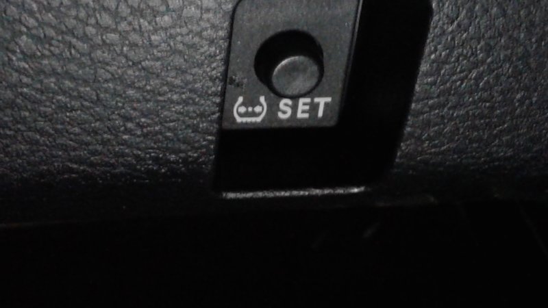

    Roflmao, I will go look, but then why does the button say "set" with tire symbold. Yup nothing in the glove box except space.here is a pic of the set button

    I know. I just went out and looked, too. God damn Google. It's not just FAKE news anymore.

    BTW when I depress it to reset it in the on position it will only blink once, not 3 times as stated here and in the owners manual
