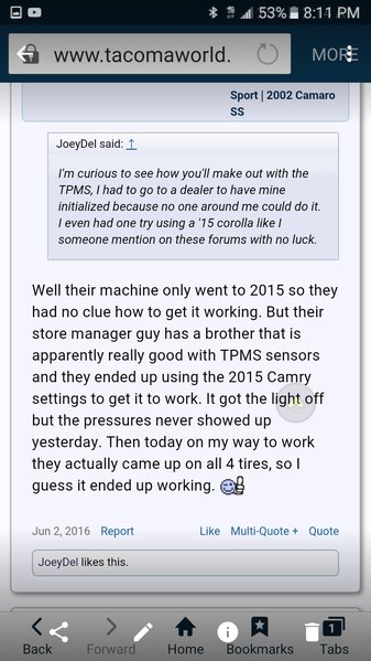

    I just bought some rims today too and was worried about the tpms not registering. Thankfully all went well today with a little prayer.
    Anyhow, I did some research for the last two weeks reading just about every thread and saving screenshots of useful information from tacomaworld. Not sure if this will work for you, but it's worth a shot.

    Did u try it with the motor running?

    Will have them give it a try, it's worth a shot

    I have tried with it off, in acc, on and running

    Damn weird. But watch it'll be a easy fix.

    Simple fix. They tool the rim and tire off and said the cord was not right inside. Either adjusted it or replaced the cord. Not exactly sure, I was not hovering over the guy. It was only one sensor that was causing the problem.
