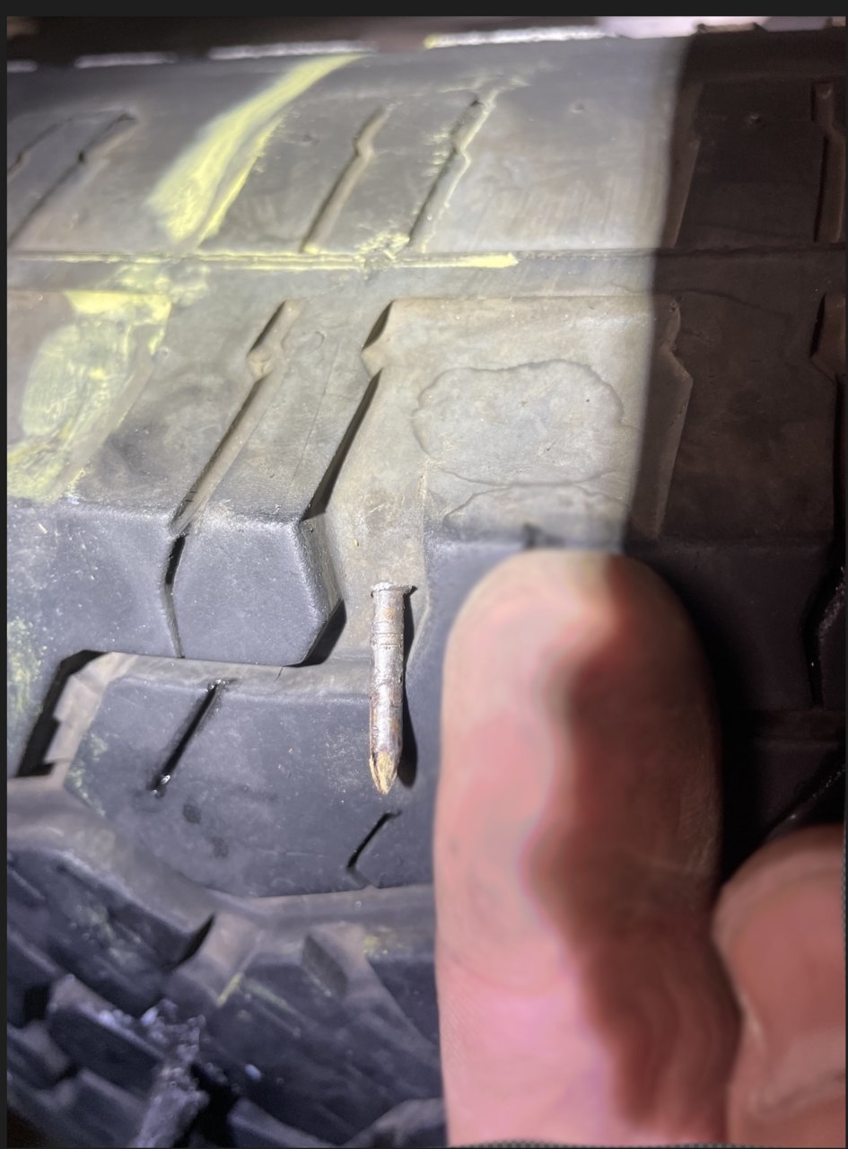

    I had a slow leak of about 1 PSI per day that went on for 6 or 8 weeks. I just kept airing up whenever the TPMS light came on, about once a week.
    Eventually I bought a standard plug-type tire repair kit on Amazon & decided to try to track down the leak.
    Put truck rear axle on jackstands, rotated rear tire & sprayed copious amounts of Windex® all over tire looking for bubbles. Surprisingly, even a leak of just 1 PSI per day is enough to blow small visible bubbles/active foaming within a few seconds.
    Located the leak which in my case was coming out from under the fully-sunken head of a short nail which was driven straight in (perpendicular) in the center of the main tread pattern.
    Extracted the nail & used the tire-plug kit to prep & plug the hole. This was about 500 miles ago & the leak / PSI loss is fixed.
    Because the hole was small, clean, and vertical, right in the middle of the strongest (belted) part of the tire, I'm not worried about it blowing out under load. If it had been at the edge of the tread or in the sidewall, at the very most I'd have just driven slowly on the temporary plug to get to a tire shop to buy a new tire.
