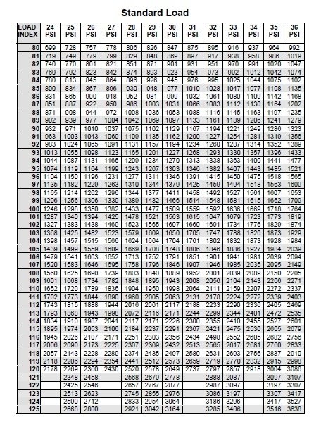

    My stock Goodyear Kevlars 265/70/16 have a 112 load index and the placard recommended tire pressure is 30 psi.
    This gives me a load requirement of 2,117 lbs; 1,924 lbs after FMVSS 1.1 correction factor.
    I replaced with BFG 265/75/16 load E. I run 36 psi.
