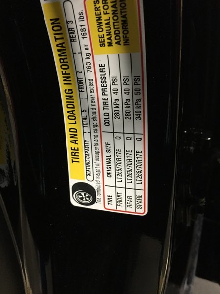

  20. Nov 18, 2016 at 8:20 AM
    #40
    Aussiek2000
    Aussiek2000 Well-Known Member
    Sep 5, 2015
    #163499
    5,652
    2016 Offroad AC
    2016 Chevy 1500. V8 4wd crew cab. Factory e tires
