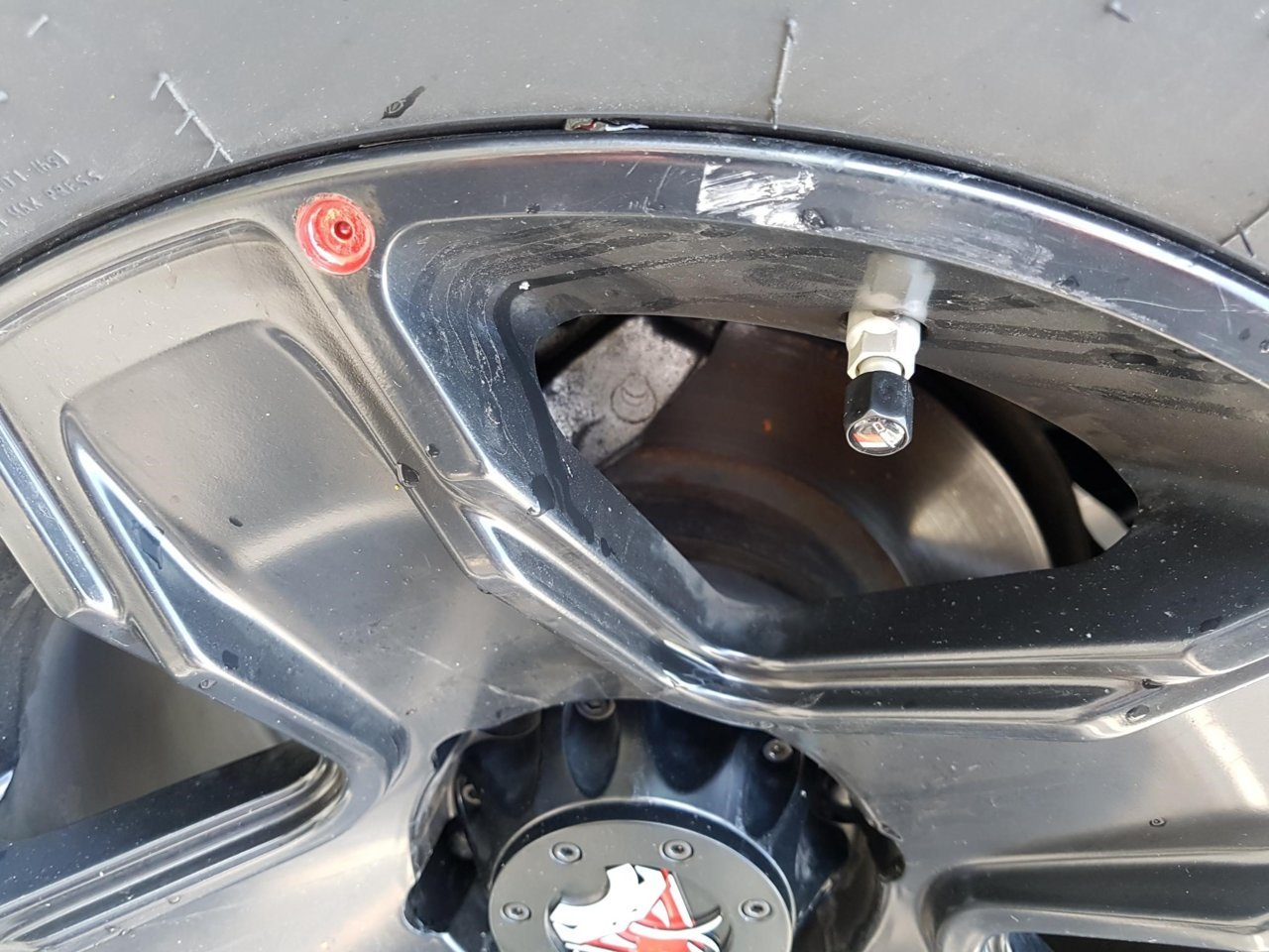

    After months of research I just flipped my LT275/70E18 BFG's (@ 65,000kms) to P275/65R18 B/S Revo 3's. The BFG's were set at a number of different pressures but 35 PSI was best. I was never able to get any kind of ride quality or MPG from the BFG's and that is to be expected given the lift and oversize.
    I was going back and forth between the P rated Toyo O/C AW and the Revo's. So far Im very impressed with the Revo's at 32PSI. Ride quality far superior and NOISE has been almost eliminated. Over 45,000 kms (1 year) i had the BFG's balanced at each rotation and they just would not behave. Glad to be rid of them....balance on Revo's is perfect !!!!!
    Im going to try running the Revo's at 32F - 29R as i only run with about 100 lbs of trail tools in the box.
    On a side note, tire shop somehow damaged (marked) all 4 wheels with a touchless tire machine! There are 3 of these marks on each wheel!
    Still have to resolve that .... Oh Joy
