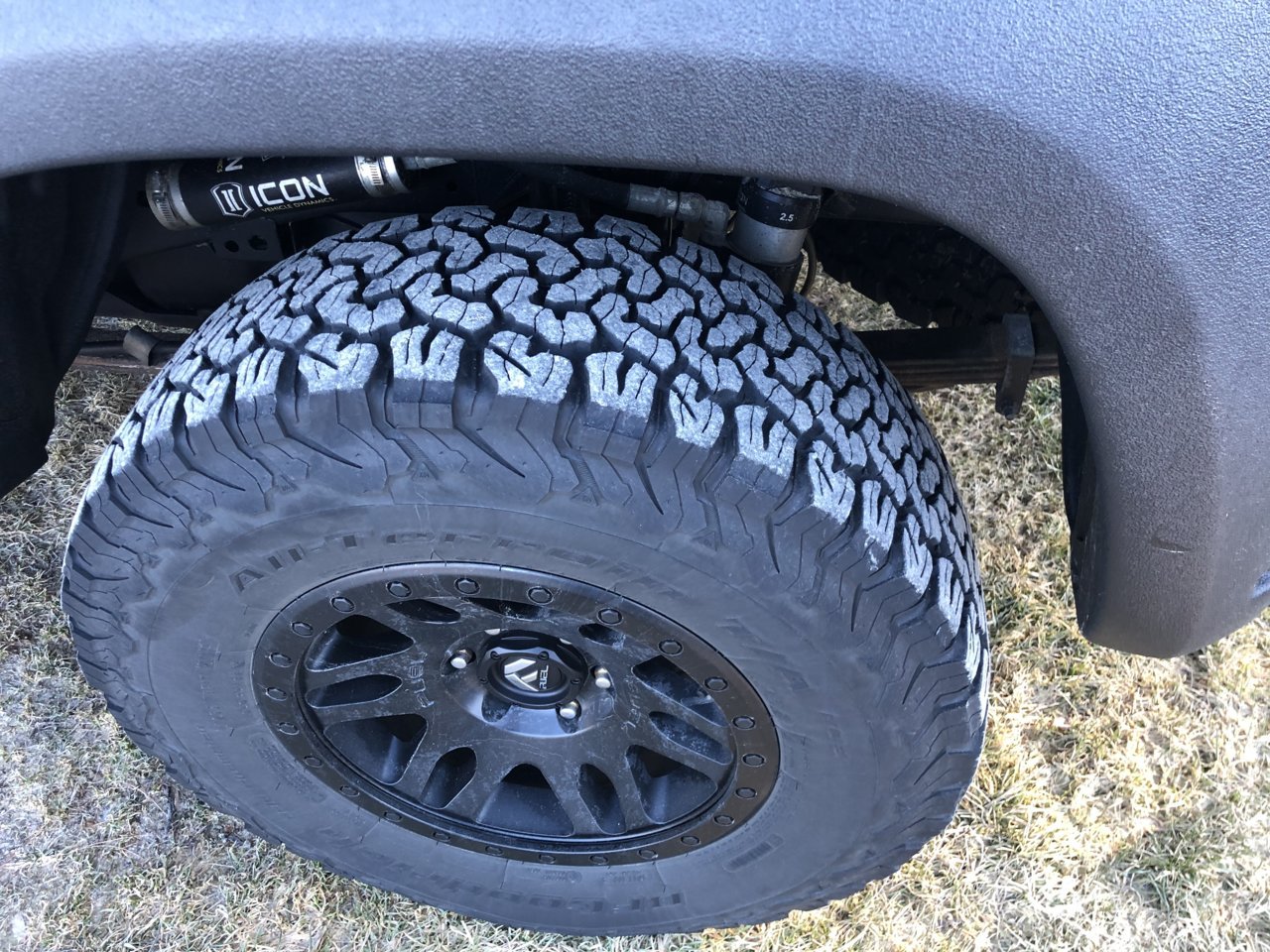

    #16
    Cudgel
    Cudgel “Tonka”
    Mar 28, 2017
    #214640
    4,307
    Live in: An Ocean of Plastic Trash
    2017 OR DCLB
    ICON8 Lift -285s. upTOPoverland rack.
    Stock is stock. Jam is acceptable.
    I am not stock. I periodically drive a dew-laden cinder parking lot to gauge wear at my most desired pressure, that, for me, balances performance with ride quality.
    If you look at the profile on edge (so called “9:00-o’clock position”) you will see my current tire pressure under my stable load and wear mileage is perfect.
    It’s a taco, play with it!
