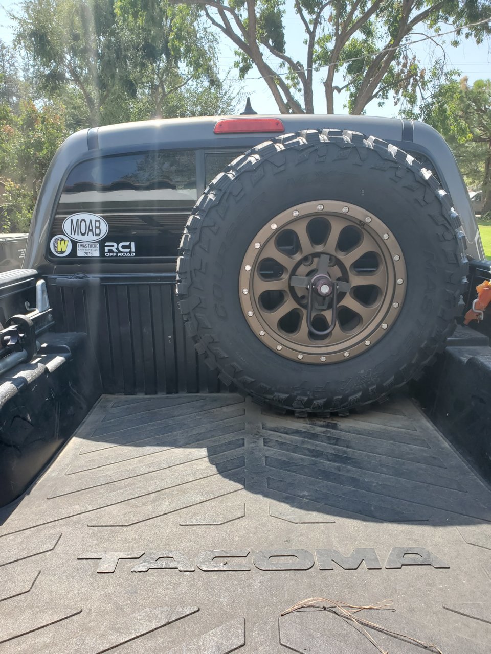

    Nice - looks like a 3/4 ton version of a Tacoma. I wish my spare tire was where yours is.

    Wilco mount, been carrying spares here for over 5 years now with no bed rail problems at all. You can also throw a lock on the mount. Works great.

    Are the Rocktrix wheels hub centric for Toyota?

    No, and you have to use an 1.25ET lug, not a problem, last 2 sets of wheels have been this type. Thanks for your interest.

    Looks like a great setup - and you mounted the tire the correct way, with the valve accessible! If mine was like that, I could have checked the air pressure already. And agreed, the bronze wheel finish pairs well with Pyrte Mica.
    I don't recall if it was this forum, or maybe a whole different truck - but I read about the spare tire lowering/raising system getting stuck or not working.

    The wheels on my Tacoma are not hub centric, not a big deal for me. The Rocktrix did come in at an attractive price point last time I looked.

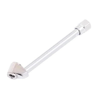

    Mine is stem up.
    It can be hard to top off the pressure with stem up.
    But once you have the right air chuck it’s a lot easier.

    2007 2.7L 5MT 4WD
    I was going to ask what an air chuck was. Could an air gauge be placed on that? I would have expected to see an end the same diameter of the tire valve.

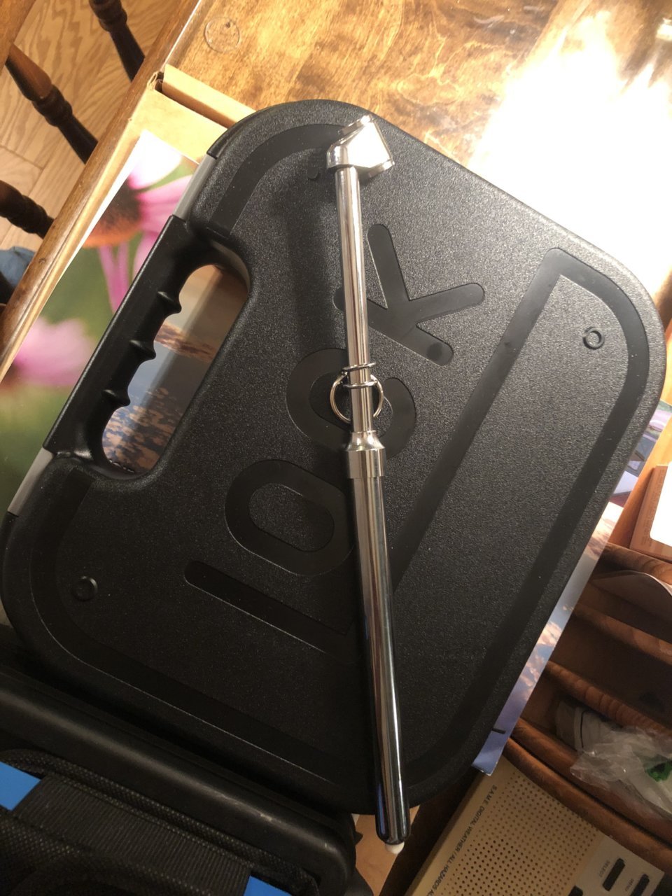

    That is my understand too. For dual wheel vehicles.
    I’ve basically been taking care of my grandparents property since I was in high school.
    As for back as I can remember, that style air chuck is what I’ve pretty much always used.
    Mostly because that’s what’s hanging from the side of the air compressor with all the other air tool accessories. I’m also still using the old style slide pin air gauge. I guess I’m a creature of habit.
    I don’t like all the new digital stuff.
