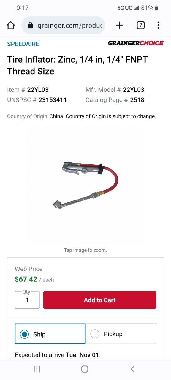

    I'm able to see and touch the stem on the spare with it pointing up. It's cap is missing, I need to get some for that and another tire. I can't get the gauge on though. If I can get the pump hose connected I guess I could just fill it for a while, but don't want to risk putting in too much.
    I wonder if there's some kind of valve extension thing, a foot or so long that as a valve at the end of it for the gauge and pump.
  12. Oct 31, 2022 at 10:17 AM
    #52
    b_r_o

    Screenshot_20221031-101719_Chrome.jpgIt's called a reverse chuck. This one is 30 degrees
  13. Oct 31, 2022 at 11:26 AM
    #53
    Stelcom66
    Stelcom66 [OP] Well-Known Member
    Mar 3, 2018
    #246129
    660
    Steve
    2007 2.7L 5MT 4WD

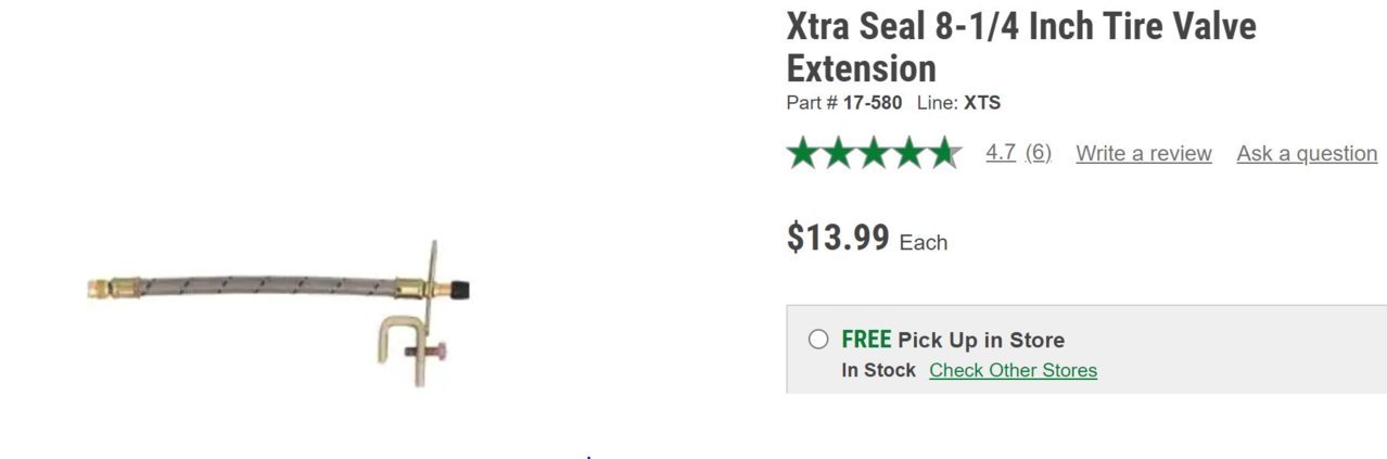

    I can't tell if the part on the end with the lever has a gauge on it, and if that's a powered air pump. I see it's called a reverse chuck, I'll look that up.
    I could get this - connect the gauge at the right end, then the air pump.

    Steve
    2007 2.7L 5MT 4WD
    I may consider one of these. After a while I was able to get the spare tire down. I oiled the winch while the tire was out. Not to push my luck though, for now I'll store it in the bed. When I need room it'll fit behind the passenger seat. First I was concerned about the spare being too accessible with the mount, but I see you can put a lock on it.
    The spare was very low. Added air to 30lbs, amazingly the TPMS light turned off. Didn't really expect that given the sensor battery is 15 years old. Also as expected it may not be good to use this spare, its a 245, what came with the truck originally. The mounted tires are 265s.
