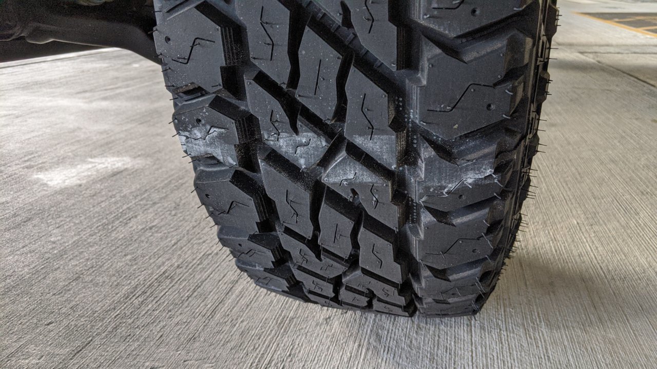

    Most folks need pressures that promote good tire wear over load capacity.
    Start with the placard rating and do a chalk test. Then adjust pressures 1# at a time, repeating the test, until just right.

    Did the chalk test on mine, 32 front 31 rear with a full tank of gas and the matching spare in the bed.
    I also have an ARB front bumper and run with my front plate skid on all the time.
