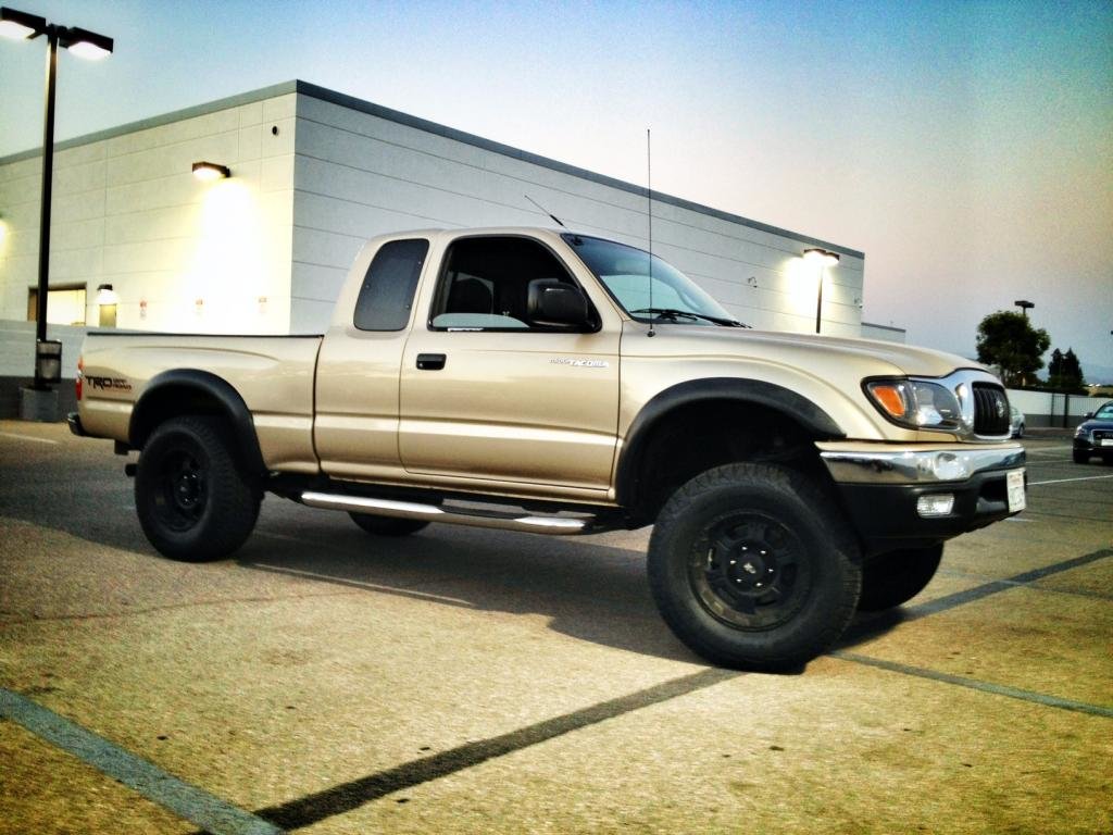

    I currently run 265/75R16 wheels on this
    and i wonder if i upgrade to 285/75R16 will it make it a bit higher?
    also what do you guys think about wheel spacers? i was thinking of getting 1 inch for a steadier ride on turns

    Stepping up to 285/75/16 will make your truck sit 1/2" taller.
    I've never heard of anyone reporting better handling with wheel spacers. People only run them to clear the UCA's with 285 width tires, if the wheels themselves don't have the proper backspacing to do so.
