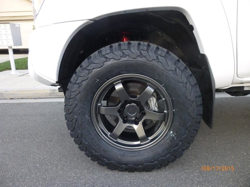

    I also have these tires and they rubbed the inner edges of my front mud flaps even with the lift. I had to take them off and trim them about 1 3/4 inches. Now they seem OK. Also removed the little front flap thingy.

    Ah I see! You have a 14 which is probably why. I have a 07 so I don't have those front flaps to deal with
