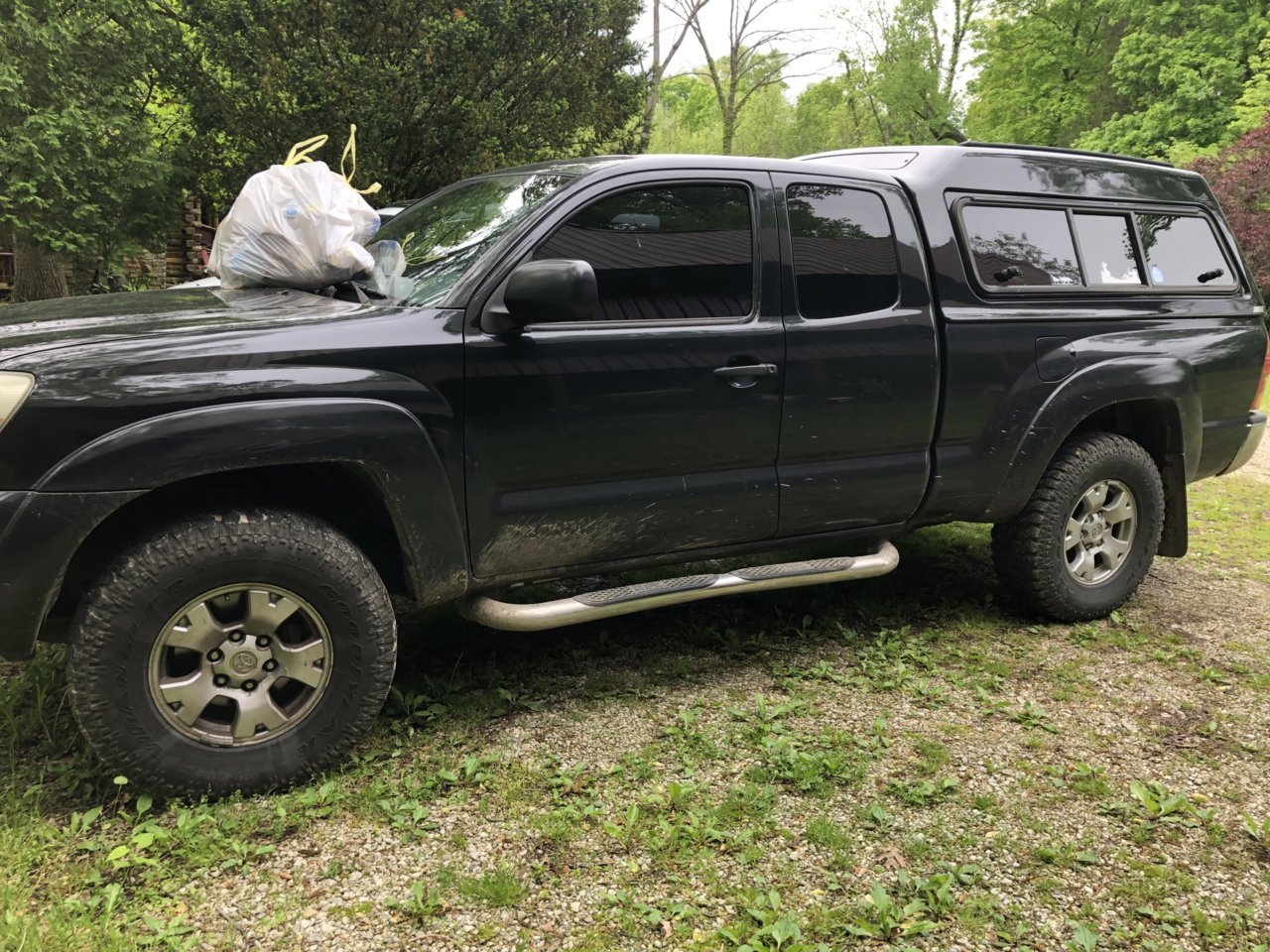

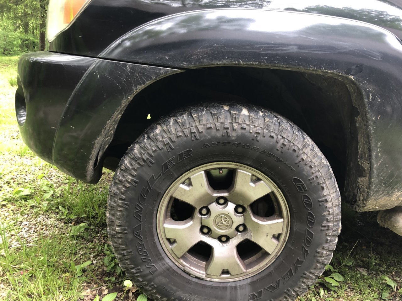

    Here’s what it looks like now. It’ll be washed after Turkey season!E0D8A0E3-9E3D-4FA8-8836-5C04DCBD6E4F.jpg7CC17E86-7A5D-458B-AB12-0C4AEA8BC2E1.jpg
