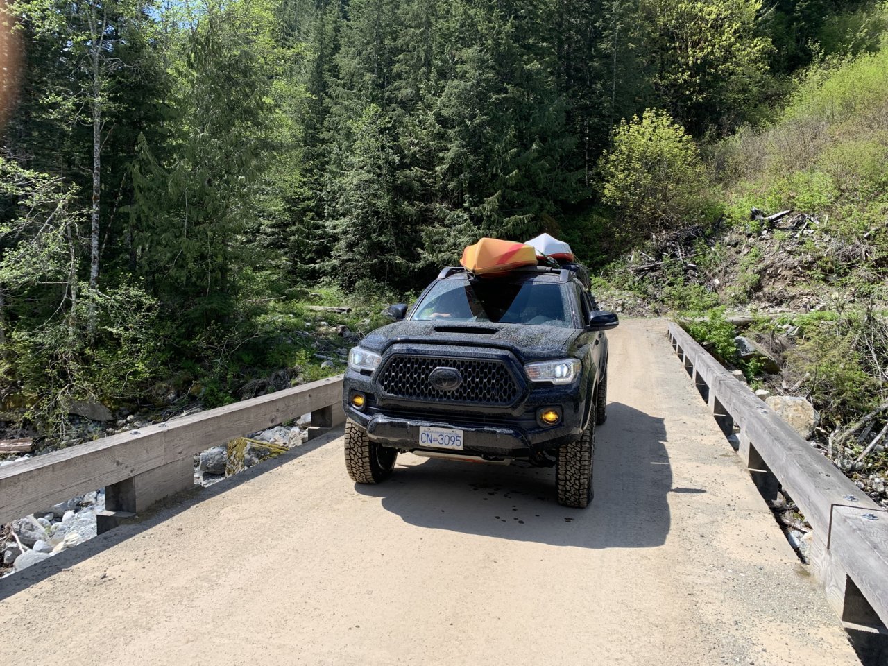

    Some Serious Tires
    255 is only 10mm skinnier than 265. Can’t really tell a difference. My 255s look just like my 265s did, just much taller.
