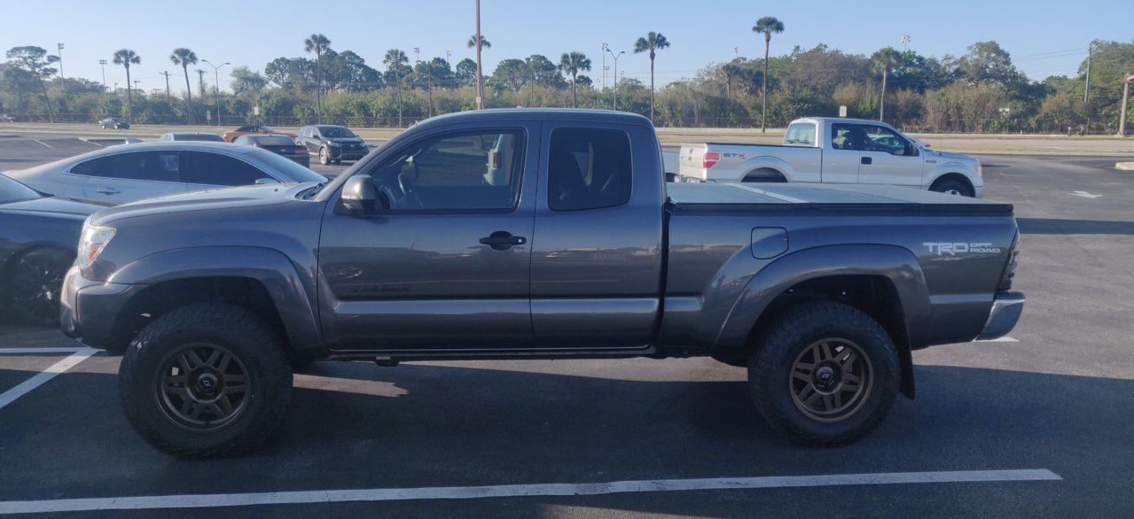

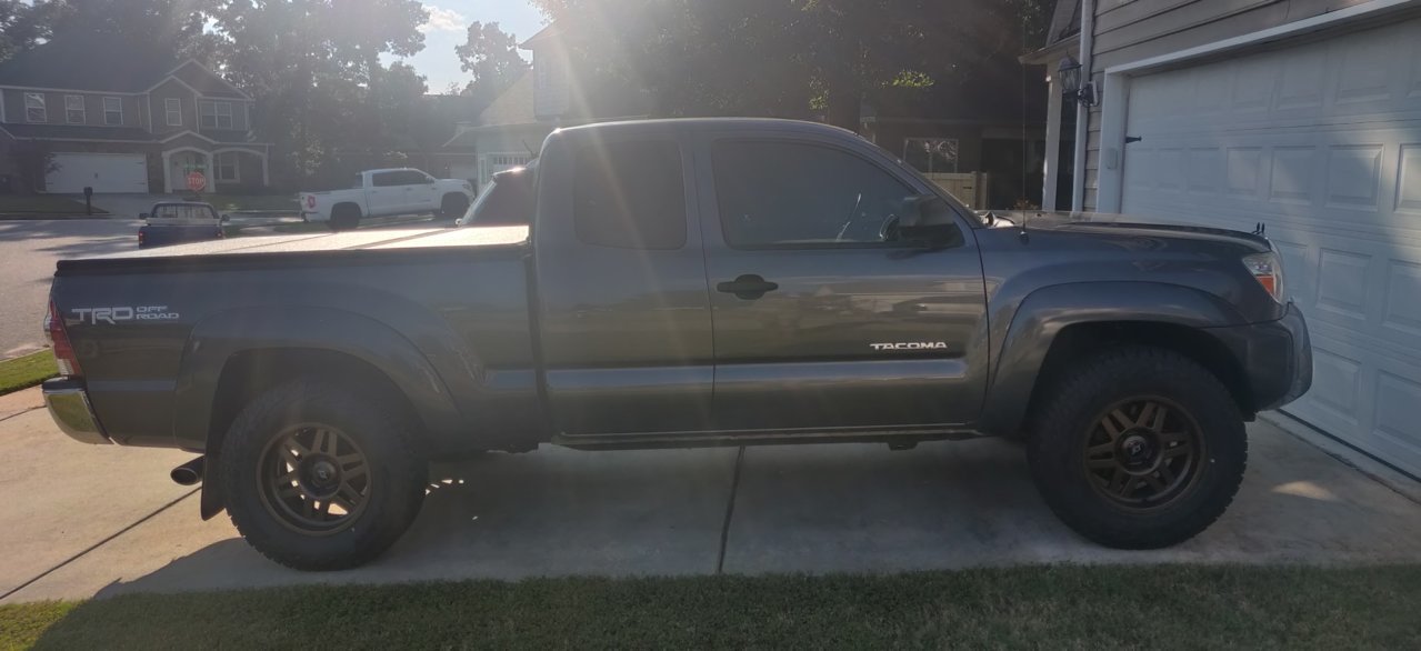

    265/70/17 Falken Wildpeak AT3s have been great for me. Awesome slightly aggressive tread with good grip in the rain. Little road noise is a plus as well. I'm in GA, so haven't drove through snow but I've read here it handles well.
    Pics for reference.
    No Lift
    With 2" Lift
