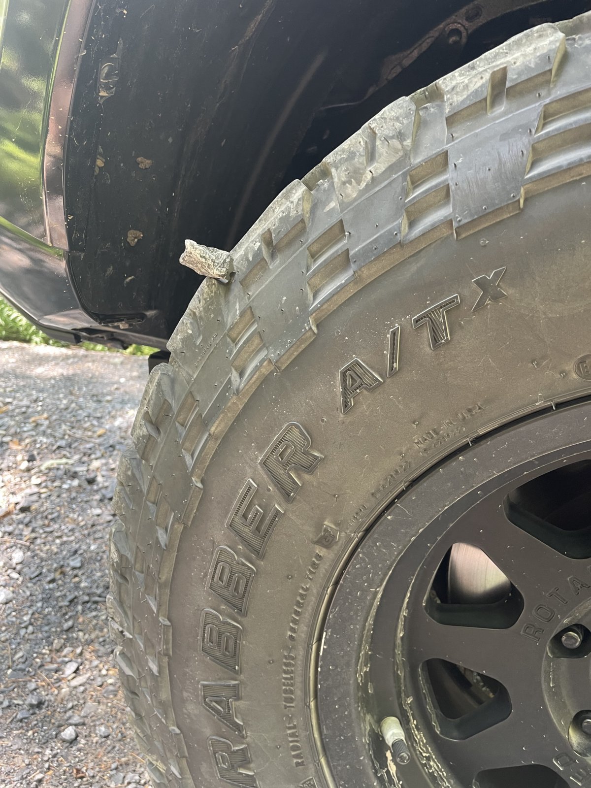

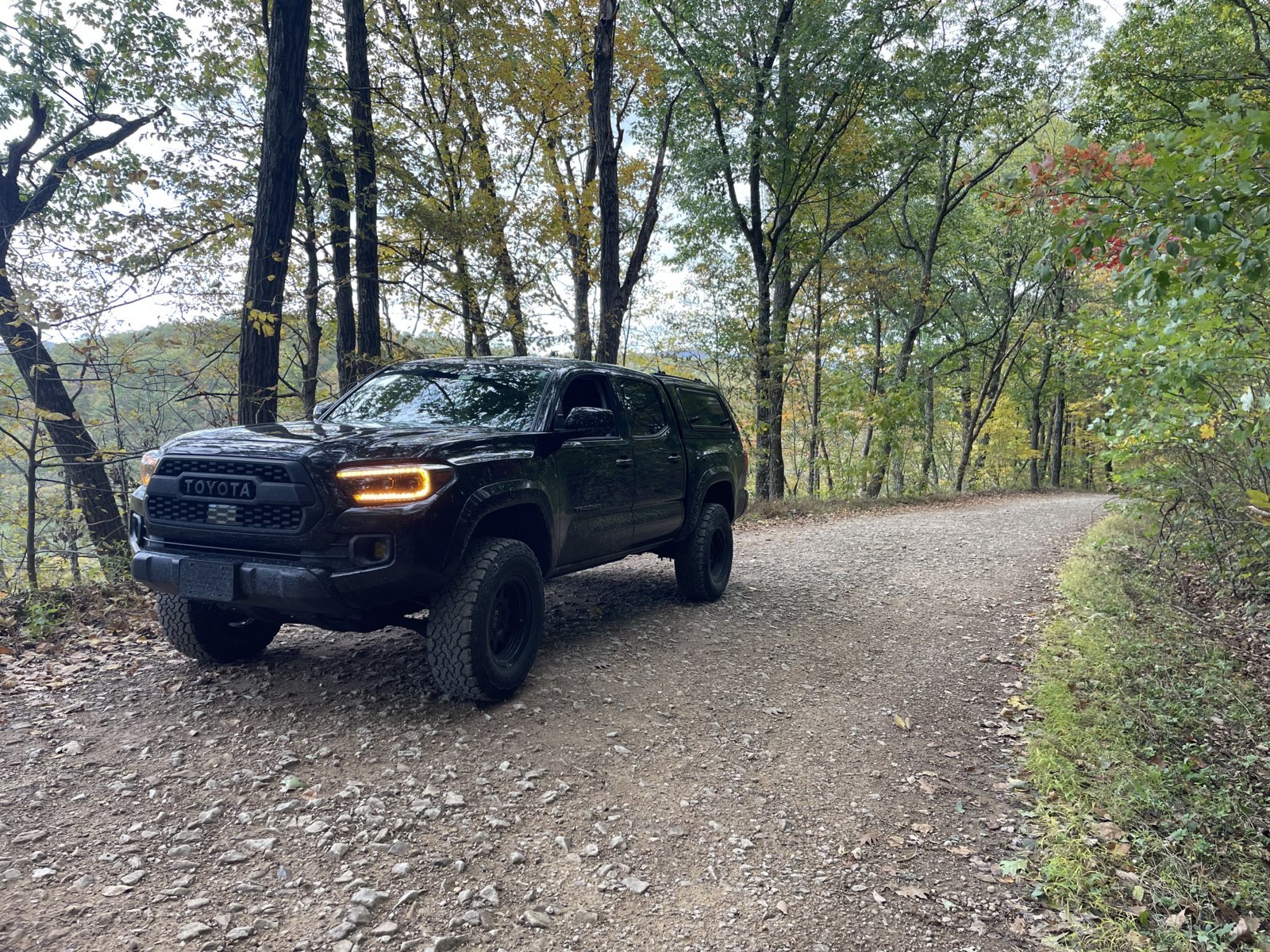

    I’ve been running LT265/75/16 General Grabber ATXs for about 50K miles now. They have been an absolutely fantastic tire. Only reason I might get something different next is just to mix it up. They’re at about half tread life (keep in mind these are E rated). I think if I wanted to do it for science, I could probably get close to 100k miles out of these. The tread life is unbelievable and they are 3PMS rated.
    As you can see, they are quite “grabby” :rimshot:

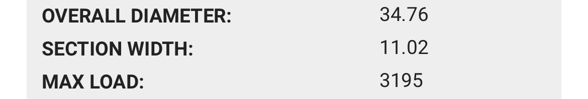

    He probably meant 34’s*

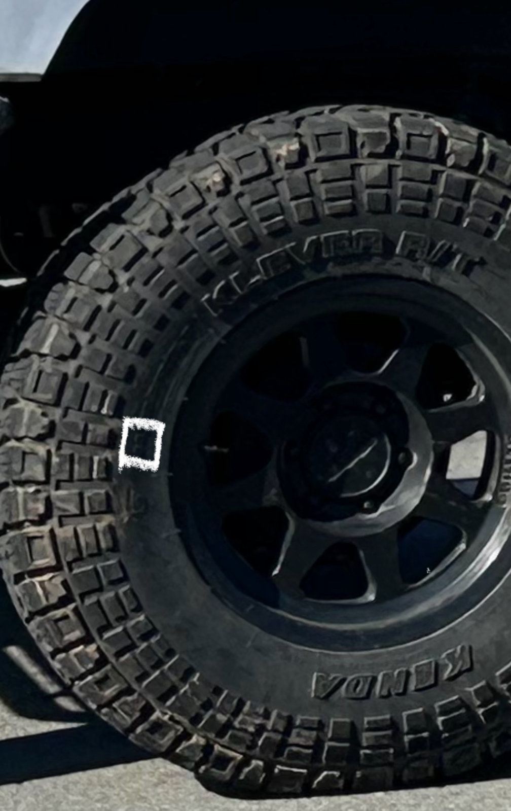

    Road_Warrior[QUOTED] likes this.
  12. Apr 3, 2024 at 3:23 PM
    Road_Warrior
    Road_Warrior There is nothing on my horizon except everything
    Aug 22, 2021
    #374919
    7,347
    East Coast
    2021 Black SR5 4x4
    Ahhh the Kendas. Another solid choice. If only they made a LT285/75/16 :pout:

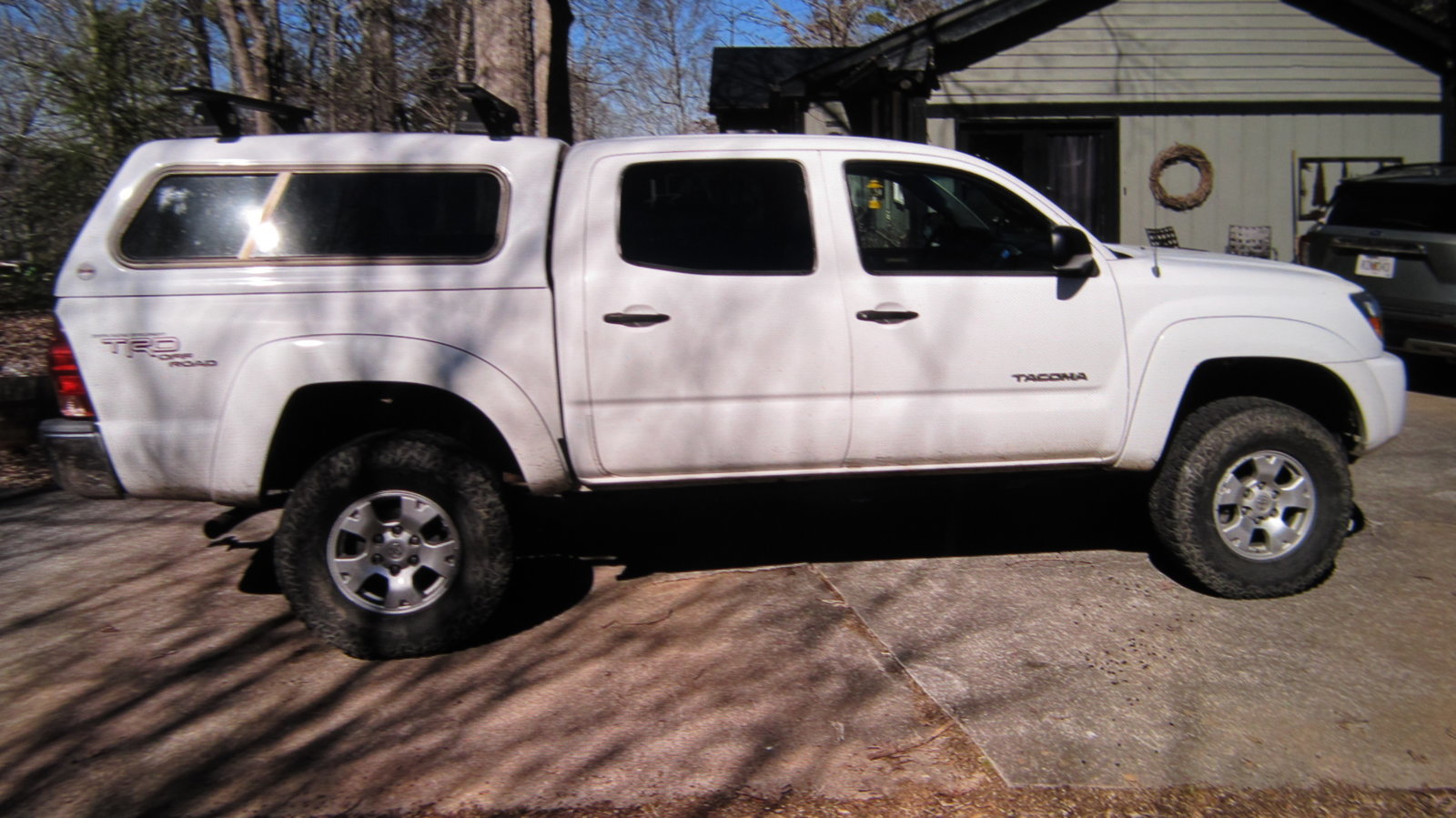

    IMO 265/75/16 is a good size. They are a bit larger than stock, but not large enough to have any real downsides. Cost is reasonable too. They are usually available in a standard load tire or LT rated if you want. I think they still look good with s 2-3" lift. Any bigger and you create a domino effect of having to do other mods to the truck. Which brand and model is personal.
    My 07 with 265/75/16 GoodYear's and 3" lift.
