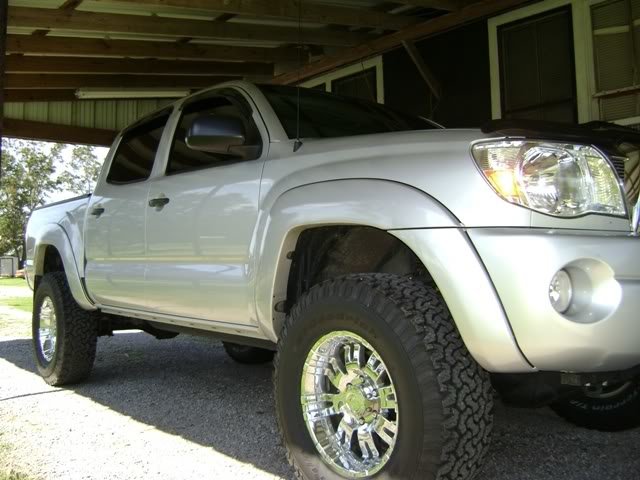

    You are correct the 33s won't fit on stock rim. I went with a 17" rim and like it but sometimes think the 18s would look better.
    My rims are 17x8 4.5 backspace and 0 offset, I have BFG AT tires 33"

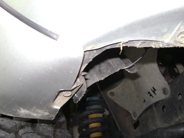

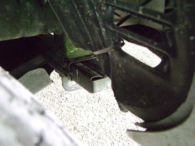

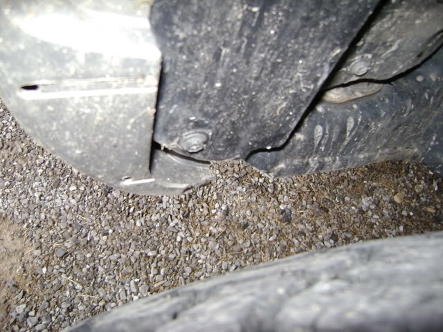

    I did some trimming, only need a razor knife to remove some of the plastic.
    This is the front where I cut and zip tied some back to keep from making contact while driving, thought it might flap.
    The large square knob in the front of the tire, removed.
    This is where I had very slight rubbing on full lock while experiencing some flex. Hard to see.
