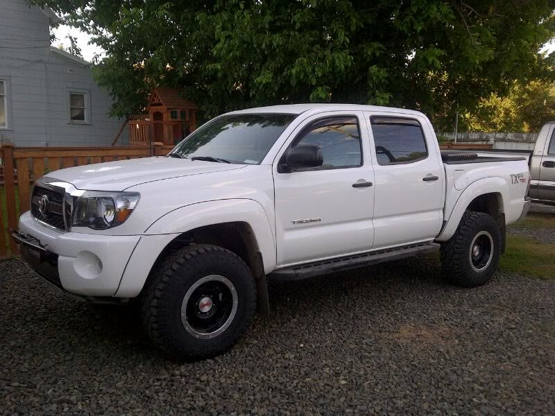

    I just had my OME lift installed today, running 265 Duratracs... lemme get pics uploaded real quick... standby...
    Here are the 265/75-16 with no lift (yesterday):
    Same tires with OME lift (today):
    In my opinion, the taller 265s fill out the wheel wells just fine. The 285s aren't any taller, and will only stick out half an inch further.
