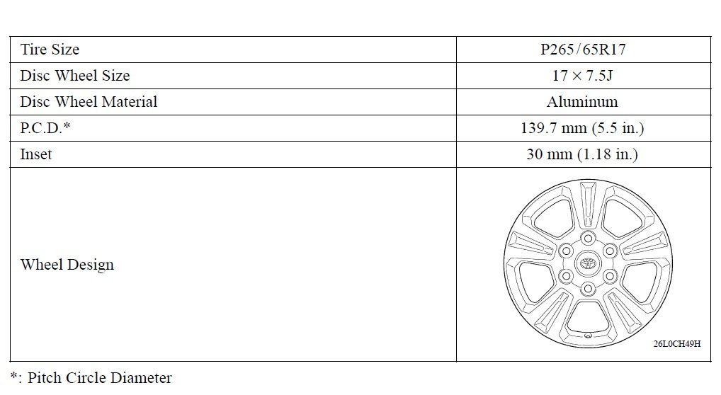

    Does anyone know what the stock offset would be for the 17" rims on my 2017 Tacoma TRD sport 4wd?

    17x7.5 +34mm and off-road wheels are 16x7 +25mm
