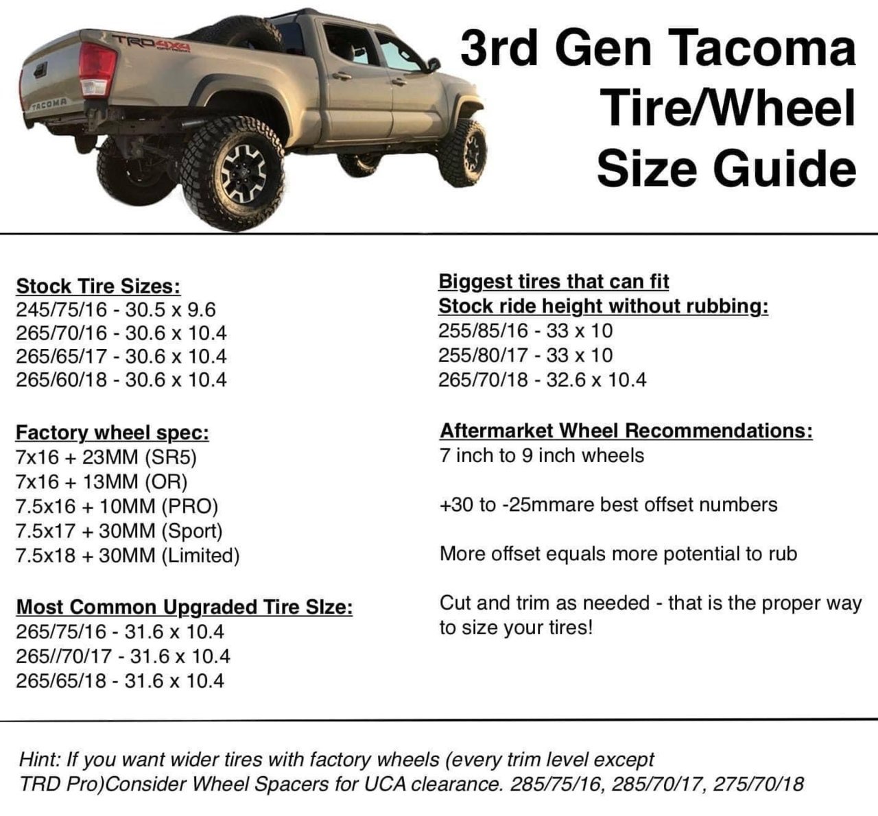

    Wondering if anyone has some tire/rim knowledge they can help me with. I have a 2020 SR Tacoma with 16" stock rims. Looking to go to 17" rims (17x8, offset 5) and tires to match. Have a 2" leveling kit. Does anyone know the largest size tire I can use? Thanks!

    265/70/17

    This is a good guide. Dont think it includes lift though

    33" pizza cutters. 255/80/17 or 255/85/16, with no rubbing, cutting, cursing, etc....
