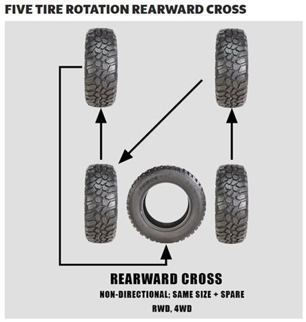

    When I bought aftermarket wheels, I bought 5 with brand new tires and TPMS in all of them.
    I bought an Autel TS508 off of eBay for a pretty decent price and use it to read the sensors.
    I do a 5 tire rotation using the "rearward cross" method and so far it has worked out great.
    This is probably above and beyond what 99% of people do. Right? Wrong? Do what makes you feel good.
