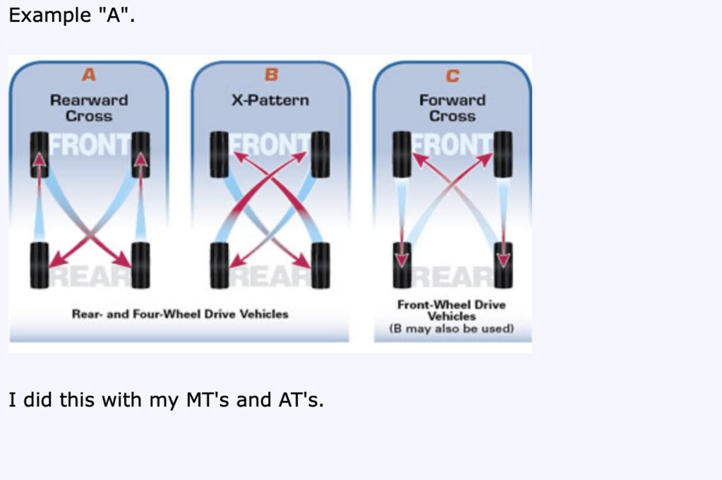

    This ia also on TW for patterns, is this reasonable?

    Yep, just don't forget the winter air :thumbsup::D

    I do front to back and back to front one side at a time. I am happy with how my tires wear and feel secure having the two opposite side tires on the ground when rotating the other side.
    Others on TW may prefer different rotating patterns so whatever floats your boat.

    Just did it the other day with two stands on the rear axles and a jack for the front. The 1st gen manual recommends style "A" rearward cross for 4x4. Had to kick the tires a fair bit to get them to loosen. Seemed fine, but I guess it doesn't fail till it does.

    owners manual recommends front to back and back to front. (drivers front swapped with drivers rear; passenger front swapped with passenger rear)
