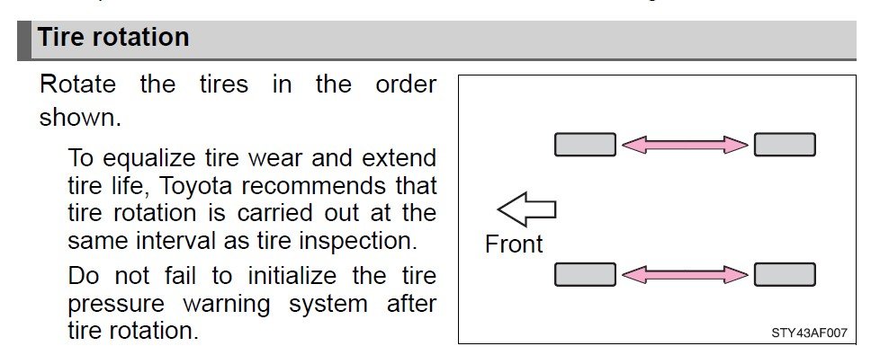

  5. Nov 22, 2024 at 7:52 AM
    #45
    pdxTacoSR5
    pdxTacoSR5 Well-Known Member
    Jul 14, 2018
    #259301
    767
    PDX area
    2018 Tacoma SR5, V6 Auto, Access Cab, 4x4, Silver Sky Metallic
    mentioned a couple of times in thread. here it is from owner's manual. also what toyota care does when they rotate tires and we all know that is the gold standard. since this is easy, with minimal equipment and no TPMS issue, i am doing it this way until i see there is a problem with wear. so far none. (this site continues to have the worst image insertion tools ever).same side totation.jpg
