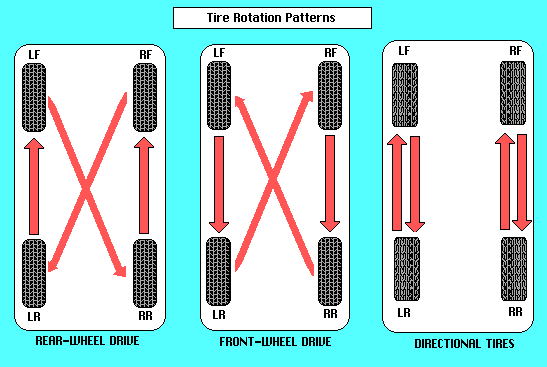

    People a lot smarter than me figured out that one of these 3 work best. Depending on your vehicle and tires.
    Although honestly, I can't see that either the left or center one really matters. Just do it the same every time. The one on the right only applies to directional tires.
    If you do it every 5000 miles when you reach 20,000 miles each tire would have been on each corner and will have spent equal time turning in each direction. At 40,000 each tire will have been on each corner twice and rotated equal miles in each direction. At 60,000, if you make it that far, you'll have done so 3 times. If you wait to do it every 10,000 miles you will be at 40,000 before each tire gets to each corner. And unless you get 80,000 miles out of the tires you'll never do it twice.
    If you have street tires 10,000 miles is probably OK. More aggressive tires need to be rotated more often. If left on the front too long, or rotating in the same direction too long they develop irregular wear patterns that cannot be corrected easily. Rotating more often prevents this. On a 4X4 truck I don't want to go much over 5000 miles.
    Also, if you have a 4X4 it is imperative that all 4 tires be the same diameter. If you have 2 tires excessively worn and 2 that are almost new you effectively have 2 different axle ratios. Operating in 4X4 will damage your 4X4 components. Even a 2wd vehicle can have issues with different size tires on the drive axle. And a worn tire is basically one size smaller than it was when new.
    There is a good argument to not truly rotate tires on a front wheel drive vehicle. The front wheels will wear out a lot sooner than the rears. When they are gone, buy 2 new tires for the front and keep driving. The 2 rear tires are essentially nothing more than trailer tires and will last a long time if just left on the rear. And since only the front tires are getting power a size difference won't matter.

    AWD, vehiles are often rotated like the one on the right directional tires diagram.

    In the end, cross rotation is great, but you get a lot of people complaining as the tire wears in on reverse rotation.
    So #1 is all I do now (on customers vehicles). That way the rear tires, regardless of car, get the aggressive tread reversal, and the new front tires don't send unwanted feedback to the operator.
    I do a complete X on all my vehicles, and any troubled vehicle. (with non-directional)
    #2 is the worst, and makes no sense. Do a full cross at that point.

    I'm convinced that the reversal of rotation is the most important thing, so I'm doing a Z pattern. I could be overthinking, but I'm having good results. :notsure:

    I’ve been doing the #2 pattern on my accord as recommended per the manual, got 100k out of my last set of tires :notsure:
