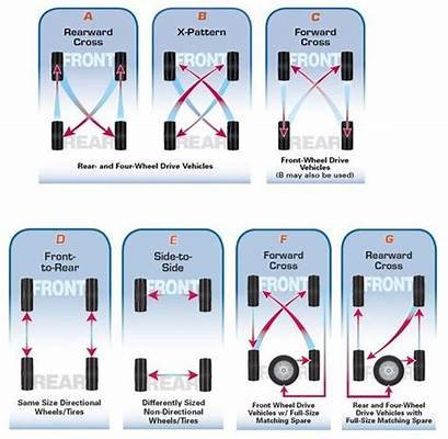

    5 tire rotation every 5k miles following the rear cross pattern in the lower right
