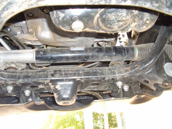

    If you look under the front of the truck, youll see a rounded metal piece sticking down. This is a jack point that is balanced and will raise both sides of the truck. Once raised to height, place jacks under the frame on both sides.
    For the rear, you can lift on the rear diff. I usually use a piece of plywood between the jack and the diff to prevent any dents. Once lifted, place jacks under the axle housing on both sides.
    Generic picture off the internet to show the front jack point.

    Wow, I didn't know what that metal piece stick down was for until now. Makes sense.
