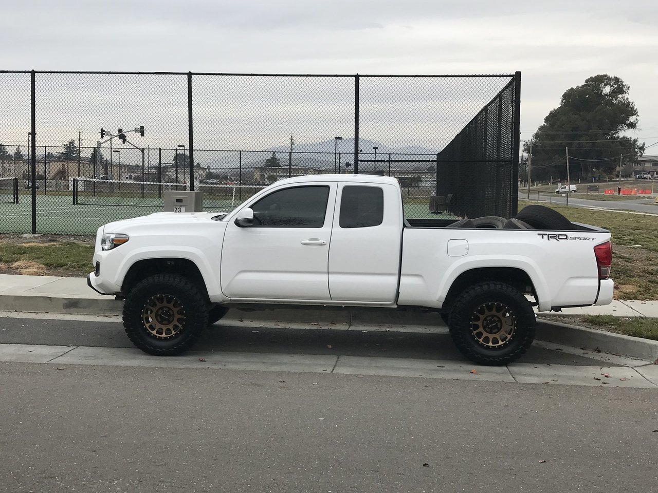

    Mine doesn’t rub at all. Had these installed a couple days ago. 17x8.5 method race wheels with Toyo MT 33x12.50r17 on a 3in Lift

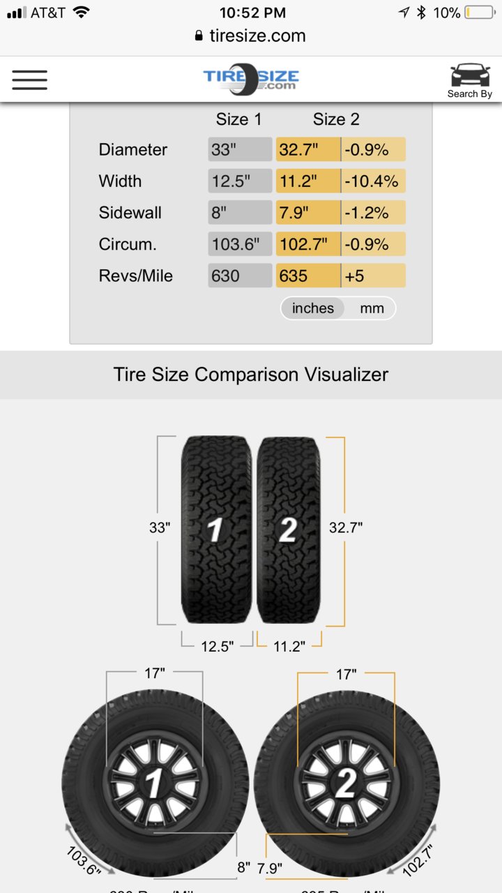

    My tires are way wider than a 285/70 tire
  7. Jan 3, 2018 at 10:53 PM
    RileyMcCoy
    RileyMcCoy Active Member
    May 1, 2017
    #217839
    35
    2016 TRD sport
    33x12.5 Toyo MT, 17in Method race wheels
    Mine are to the left and the 285s are to the right

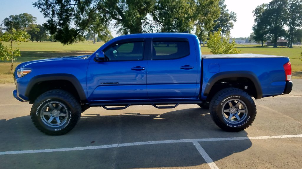

    I'm running a similar lift (about 3 inches) with 17x9 -12 offset rims w/285/70/17 tires. You will more than likely rub at full lock in reverse. If you plan on off-roading much, CMC is a must. If not, the CMC would remove the annoyance of slight rubbing, but it wouldn't be a requirement.
    If you are worried about rubbing or needing to do the CMC, go with a less aggressive offset.
