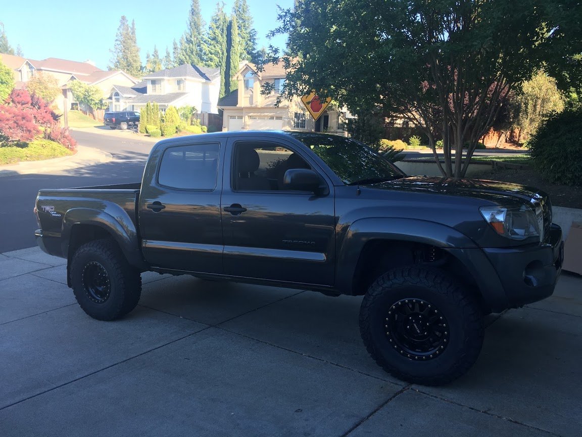

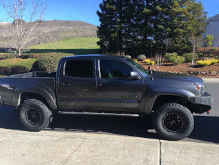

    I have a 3" lift with es6000 shocks and whatever bs springs I got from them as well. Not sure on my true lift height but I run 285/75/16 KO2s and not too much rubbing. I have aftermarket wheels tho with 4.5 BS. I took off my mudflaps and I also have a high clearance front bumper so that eliminates the issues in the front. Havent done a cmc yet but in the future I am sure I will. I only rub when I brake hard and make a turn

    Heres how the fitment looks with the stock bumper and with the aftermarket one
