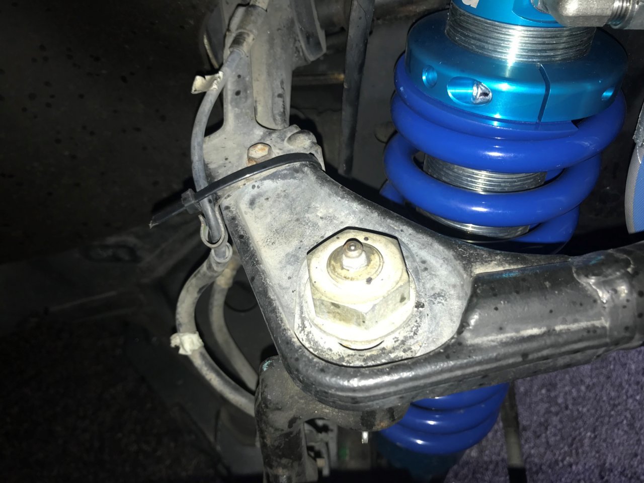

    I am a complete Newb when it comes to adjustable UCAs, their settings, and alignment.
    Here are some pics if it helps:
    (Passenger side)
    (Driver Side)

    Thanks for addressing my specific swaybar question. From the responses I have gotten this far, sounds like I just need to go to an alignment shop that specializes in alignments for our types of modified trucks. I do not conceptually understand alignment specs enough to baby sit a tech. I need to find a loading dock or something to try and find the rub too.
