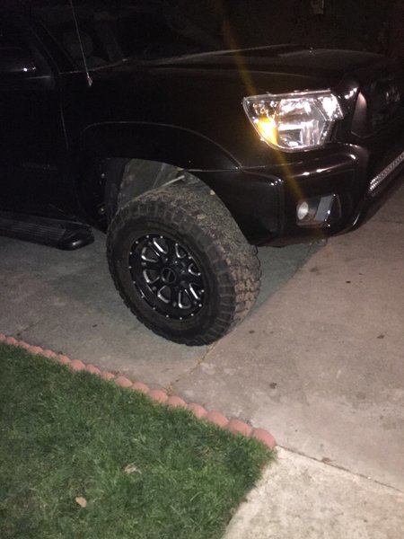

    image.jpg image.jpg I have a 2005 Tacoma with a 2.5 leveling kit with 17inch rims on 32 inch tires the back of the front tires rub the frame. The wheels and tires look to good change. Any ideas? With out having to do to big of a lift.

    and probably going to cut that bumper

    Cab mount chop and/or aftermarket upper control arms.

    What will the upper control arms do?

    The upper control arms will give you the ability to move the actual location of the wheel in the wheel well forward. You'll need adjustable upper control arms like the SPC UCA's.

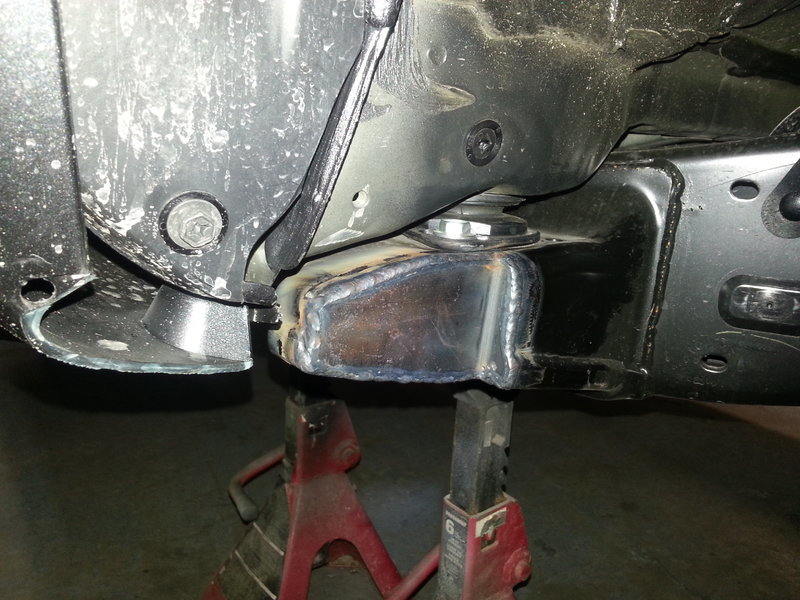

    What did you cut it with?
