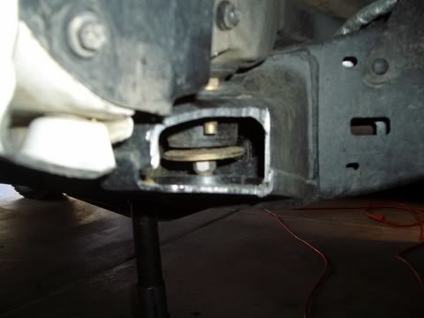

    its the body mount, its common, find a fab shop to chop it like this:

    A few bolts are different.
    mine does it too, more so on the drivers side. Trimming the body mount and then boxing it back by welding on a plate to the open hole is one of the only solutions.
    Edit: x3 for above posts, too late finding a pic.

    I have not done this yet, the pic is from another forum. There is no way in hell I would just leave a gaping hole in my body mount. However I will be doing this when my buddy graduates from welding school In about a year:D.
    The key is to weld the plate back in and paint it up real nice like you never cut it in the first place (pic 1).
