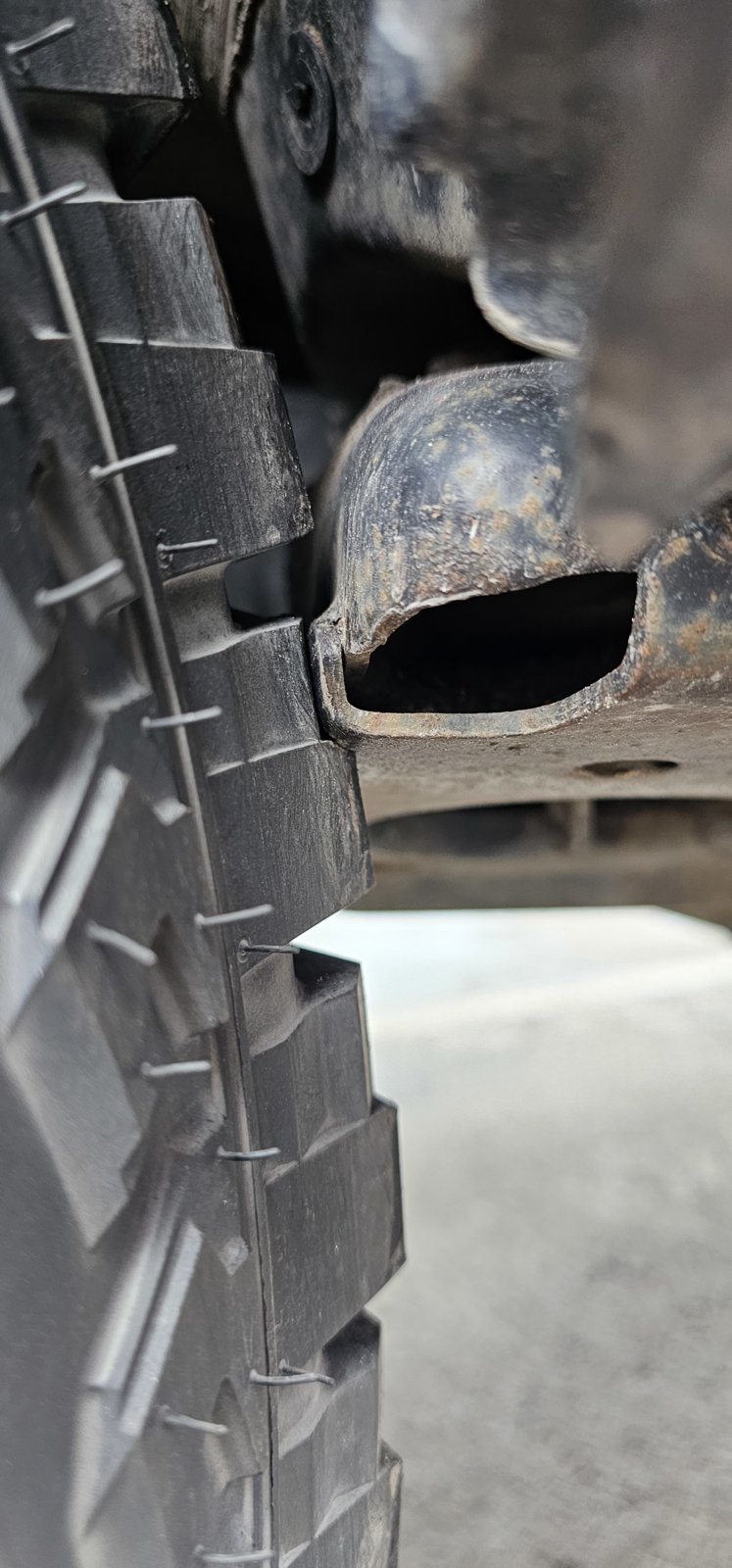

    Well, this is new to me.

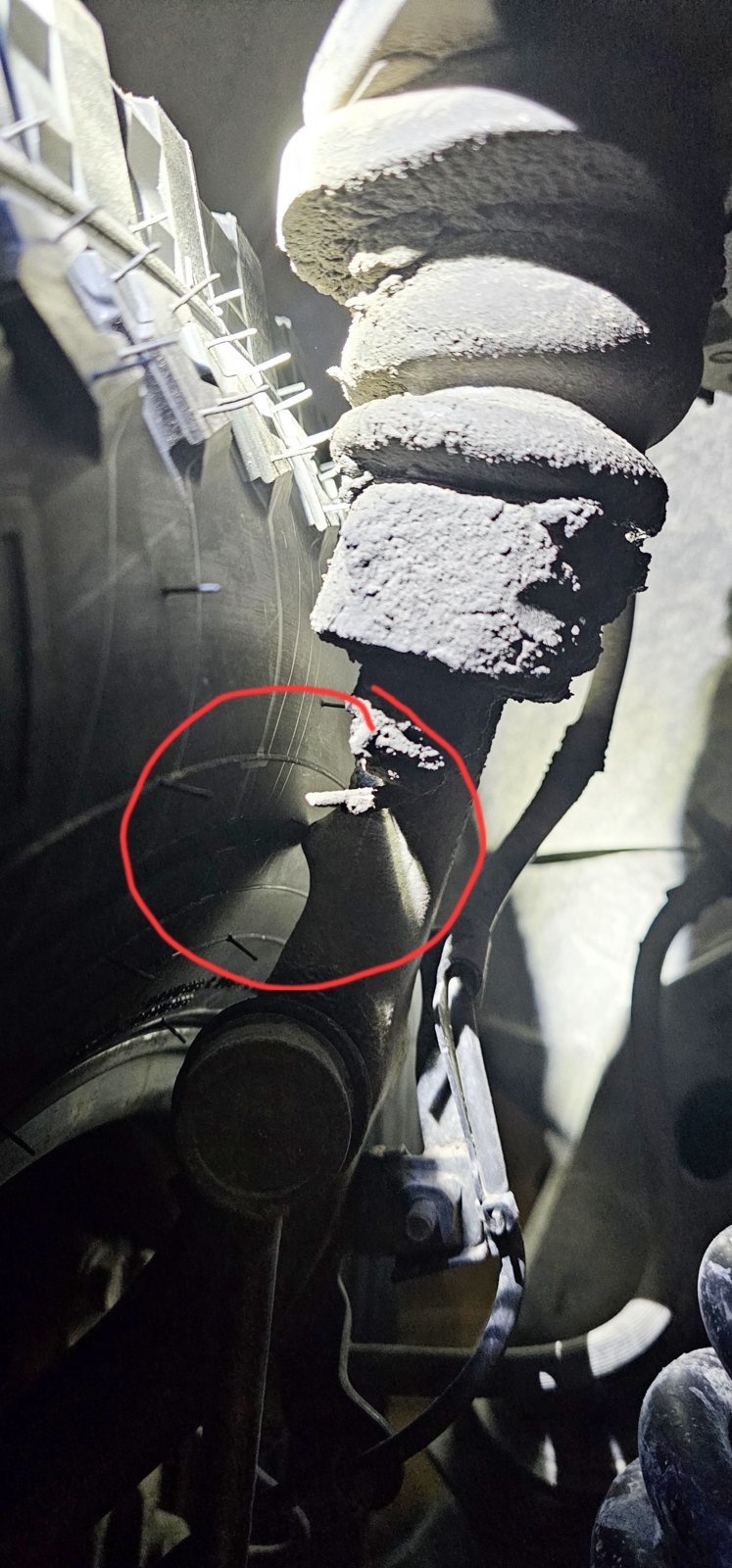

    I recently purchased a new set of tires and added an alignment. This is after I had my shocks rebuilt last week too so anything is a culprit.
    When I picked the truck up and took a look around the truck, I noticed the steering knuckle is making contact on the tires.
    I brought it back to Les Schwab and they are unsure of a fix other than shaving off that little "nub" which I was actually fine with.
    I'm now racking my brain on why all of a sudden this is an issue.
    285/70/17, Stage 1 Icon, same tire size I've had for years with SPC uca's and no spacers.

    Alignment isn't going to affect the relationship between the tire and the top of the knuckle. You're looking at wheel offset and tire width. All these tires are a little different even if they're technically the same size
    Even if you grind it off that little nub the tire is likely still going to make contact when it flexes going around corners and stuff
    You need some spacers or different offset wheels.
    Even though you've had previous 285s fit without rubbing, it's a stretch to expect that size to fit every time
