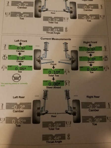

    Hey y'all,
    Few weeks ago i just recently put on a 3" lift from toytec with JBA offroad UCAs and ever since putting it on i have noticed my passenger side front tire, has a horrible rubbing sound when backing up specially and sometimes at a full turn going foward. I have already trimmed some of the inner part of the flare and run w/o mudflaps, yet still doesnt fix it. Any suggestions? Do i need to trim more of the flare off because i feel like that would fix the issue or add a 1" body lift?
    As additional information i have 1.25" spidertraxx wheel spacers. I don't want to remove these at all but if i have to i will to fix issue.

    Have you removed those little plastic flaps on the front of the wheelwell ? Also you might want to check what your caster is set at, with aftermarket UCAs you should be close to 3, you might not rub then

    The front of wheel well i dont get close to. It may be my caster.

    I got about 2 on caster should 3 get it more to center?

    Thats what I have read on here, if you are close to 3 it should cut down on the rubbing. What rim offset do you have ? My SCS rims are out a couple inches more than stock with -10 offset and 4.3 back spacing, and I have minimal rubbing on mud flaps.

    Its the spacers

    2 degrees is pretty good for a 3"lift. It seems like you have offset aftermarket rims on top of spacers, so you've answered your own problem.
    You could also weld in a steering stop pad to help prevent rubbing, but then it will turn like a pig.
