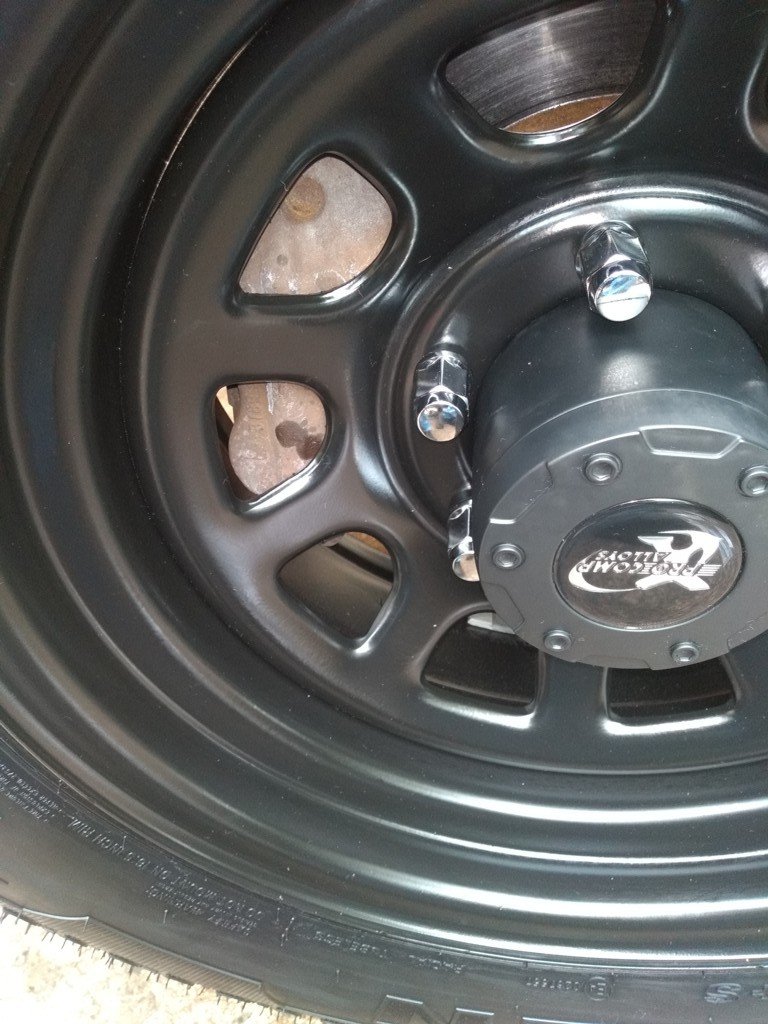

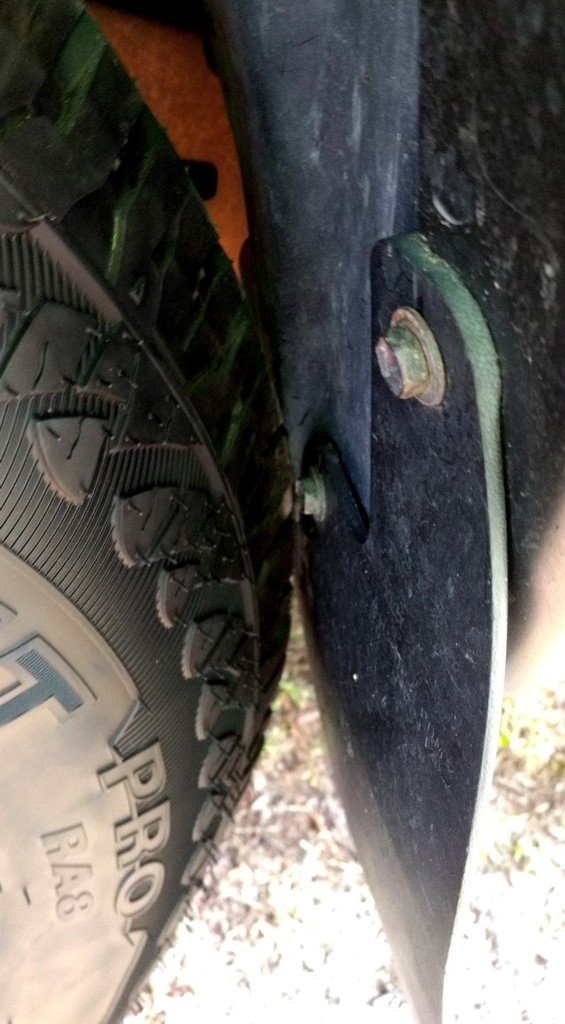

    Running 245/75R16s with 1" spacers on the front produces the rub in this picture. I may need to drop down to a 225/70R16 just to bring in the outer diameter just a bit.

    Have you had a wheel alignment lately ?
    Might want to try moving your wheel ahead

    Lose the spacers

    I think I'll take it to Firestone to see what they can do. I'm sure it can benefit from an alignment.

    I think I need to lose the Pro Comp Series 51 D Slot steel wheels so I can lose the spacers.

    this. go back to the stock wheel or one with a 4.5 BS and you'll be fine

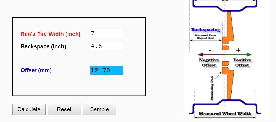

    These actually have a 4.5 BS. But the offset is -6. I think I could have bought some new black OEM TRD wheels and came out money ahead and with no headaches. This has been like falling into a pit of quicksand. You just keep sinking in deeper.

    How can you possibly make it rub with SMALLER tires than what comes stock??
    Take your spacers out. And get some wheels with the proper backspacing and width.

    Should be fine then... Ditch the spacer and get an alignment - see if that helps. It's not negative - see below.
    for reference:
    http://www.gtsparkplugs.com/Backspace-Offset-Calculator.html

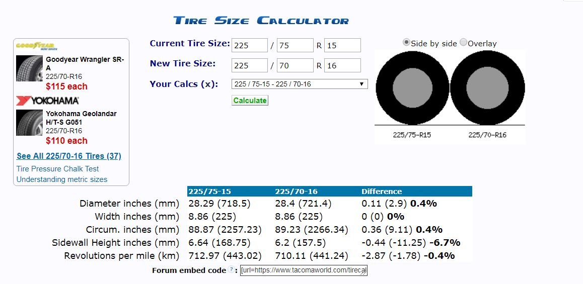

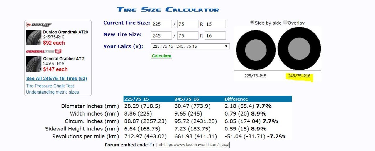

    The stock tire size is 225/75/R15. A 225/70R16 is very close to the stock size.
    The 245/75/R16s that are on it are larger than the stock R15 size. So I was headed for trouble by trying to get to a 30.4" outer diameter.

    For sure, getting your caster adjusted will help a lot, especially when you run aftermarket wheels. On 2nd gen if you are around 2 for caster you minimize rubbing issues, I have SCS wheels. Not sure if 1st gen numbers are the same but probably pretty close.

    I just took it to Firestone for an alignment and another wheel balance. Just after I bought the Taco I bought the lifetime balance and alignment package. The alignment package pays off for when I start refreshing suspension components. We have a good Firestone store near me. They were cool with the 1" spacers.
    This is the first time I'm getting it aligned.

    Firestone said it was in alignment. Touched it up a bit. Also, reported the driver side inner tie rod should be changed at some point. I'll just get new inner and outers.
    Ball joints checked out.
