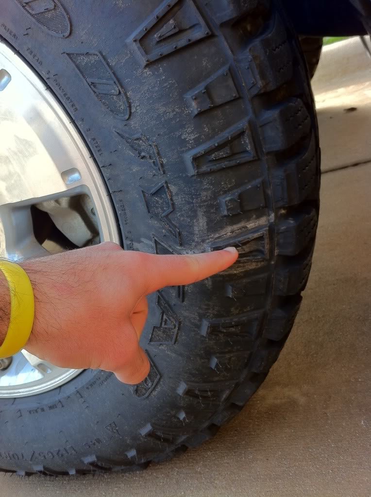

    Here's a picture of the affected area. It's very very close to the tread. It's actually within the armored triangle deal. The white stuff is where I had him chalk the spot so I wouldn't lose it.
  14. Feb 10, 2012 at 8:37 AM
    babytruck
    babytruck Babytruck, babytruck...I've got a babytruck :)
    May 17, 2011
    #56797
    8,985
    NorCal
    2010 Barcelona AC 4x4 4.0 6spd
    Move your finger, I can't see, dangit.

    First off, I'd move it to the rear of the truck. Regardless of what you decide, I wouldn't put that tire back on the front. Safest bet would be to replace the tire. Sealants and/or plugs could work and you may never have an issue with the tire for as long as you own it. The problem is, with sidewall punctures, you never know.
    Maybe plug it and make it a full size spare?

    if the hole is a pin prick throw a patch on the inside. You'll have to find a shop that will do it but some still will. They just won't warranty it for on road use. or do it yourself
    then stick a bead of rtv on the outside or if it's big enough plug then patch and then rtv over the outside

    It's a pin prick for sure. Takes something like a week and a half for my TPS to come on because of it. Like I said, there doesn't appear to be any scuffing in the area and it doesn't look damaged at all.

    Personally if it were my tire I'd find someone who would patch it. I'd just keep an eye on it afterwords.

    Put a plug from the outside and forget about it, I've done it for years countless times and no problems so far.
    I carry a plug kit and compressor on my truck and saves a ton of time when I get a flat, my spare only comes out when the failure is catastrofic and will not hold air with the plugs.
